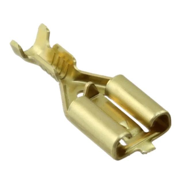

How often does the burnt connector and haness happen on the hummer? Mine has had to be replaced twice in two years!

Correction. five years!

thank you Doc Olds. actually it was the high cool number 4 on the ac. the switch inside looked burned or melted. I used to be a mechanic and fiddled with it (got a partial harness with a resistor it seems to have fixed the problem.I just aquired this hummer h3 2009 and have had it about 2 months. first had to have a transmission put in. then the number 4 on the air went out. I look forward to learning on this site. I appreciate your reply.

All models were recalled ( 15042 ) replaced before you got it. All I did was install 10397098 & 1 female spade. Still oem connector/harness. No problems since.
