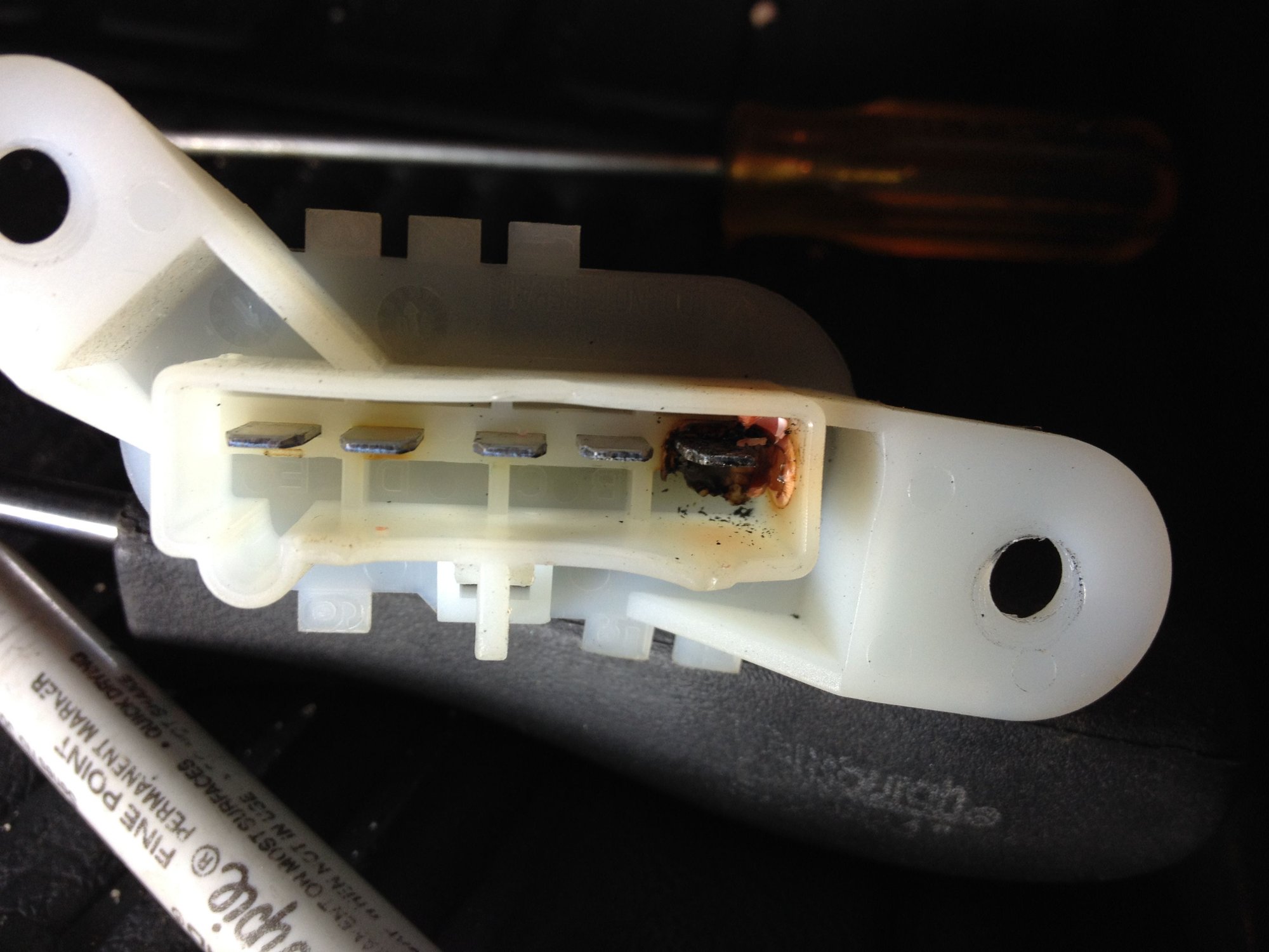

Look here:

Thank you where is that part located ?
Old Jun 11, 2021 | 11:17 AM
Posts: 9,015
under the glove box

Thank you I will check that out , what's the name of that part ,that I'm looking at ?
1580647 Blower Motor Control Module(AKA: Resistor)

How did that corrosion get under the glovebox & into the Blower motor control module?
Old Jun 11, 2021 | 05:15 PM
Posts: 9,015
The corrosion is from inside the HVAC case, causing high resistance & burns the connector. All good now with the updated module. Here's an example:
