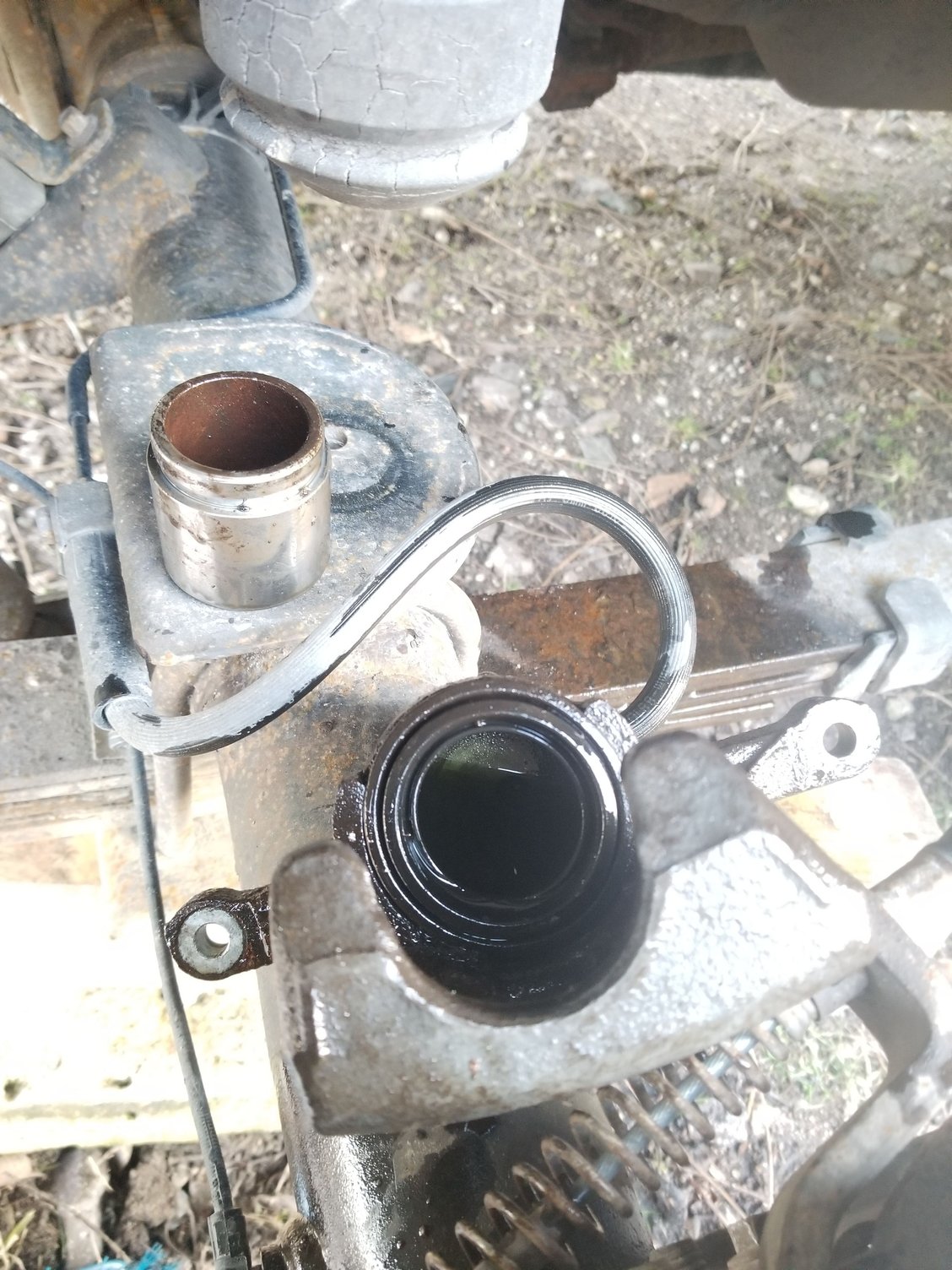

Ok, l am not a mechanic in any way, shape or form. I am currently single and have never done any mechanical work, so this has been a challenge. As far as the rim's, yes they are after market. I bought my Hummer in October as is. I had the brakes changed in November and last month I tackled the radiator thinking it would be easy. After all, it was a 6 minute video on Youtube😁 6 hours later I accomplished my first radiator job! Now this has been a nightmare.
I never felt anything out of order. I was on a dirt road and it locked up.
Now I have been working on this for 3 days. My caliper cap fell out. So brake fluid leaked. I was told to put the cap back in and bleed the brakes. Is there a trick to getting this cap back on?

I just want my Hummer back! Day 5 and still on blocks😭 I have ordered a new caliper.
The parking pin on the other side is broke. I have completely removed it. I live in Kansas and have never used my parking brake. I have been told both ways, one/ if I never use it than just leave it out and 2/ it must be put back in that it will mess up my entire brake system. I am trying to do this right and not jeopardize any future problems, but i am 3o miles from any mechanic or autoparts store and on foot. I'm so close...yet, so far.

Caliper cap? The reservoir cap? The caliper piston? The part that touches the brake pad or the part under the hood?
caliper
Brake caliper piston. Sorry, I am not a mechanic or claim to be. But, I am not afraid to learn and try.
Old Jan 21, 2020 | 09:53 AM
Just buy a new brake caliper. No sense in trying to rebuild that one.
Under $80 @ AutoZone or Advance Auto Parts.
Make sure to order/buy the correct side.

Thank you for all your help! Replaced the caliper and managed to put it all together. Other than the studs were too short and I had to go get longer ones, it is all put back together. But, oh the message panel is lit up like a Christmas tree. ABS, Stability system failed, my brake light is constantly on and check brake fluid. Which is full.
Old Feb 7, 2020 | 07:40 AM
Did you fix the E-brake on the side that had a seized pin?
Old Feb 7, 2020 | 10:11 PM
Posts: 3,204
you have to bleed the calipers.
