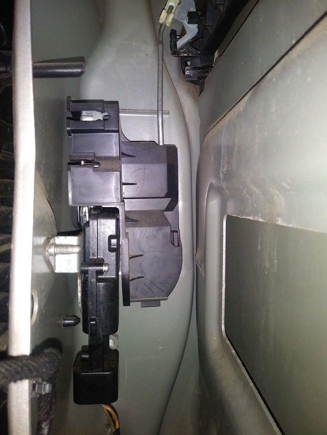

Endgate is simple. remove the entire panel, disconnect rod to handle, disconnect connector to lock actuator, remove 3- T-30 bolts on latch(door jam side), remove 1 bolt on inside.
Try clean/lube and check operation.
Pic looking from the access door panel.
