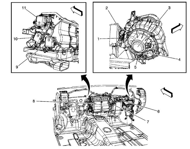

Check the actuators, 3 mounted left center dash (2-air temp & 1-mode) and 1 mounted right center dash (recirculation).
#6, #9, #10, & #11:

hi thanks for your message.
ok, according to where I listen the noise it coming from the area where actuators 11, 10 or 9 are located.
when you say "check" what do you mean?
maybe it's good to mention sometimes after a while the noise disappear, sometimes
can you give me the name for those three actuators?
thanks
Old Jun 1, 2020 | 03:40 PM
"CHECK", look see feel touch smell listen hear, I don't care what you do if it's making noise you have to figure out which one, or replace all 3? Put your head up in there and look and feel it, whatever..
"NAME" I posted above, 2- air temp door actuators (left and right) #9 & #10, and 1-mode door actuator #11. Temp door, controls the heat and cold air mix temperature. Mode door controls where the air flows, dash/center/floor.

ok I tried to identify the one touching it, but it was impossible, one thing is that the noise disappear when I disconnect the harness from the mode control, the one in your right, any idea?
the three you mention are the same P/N?
