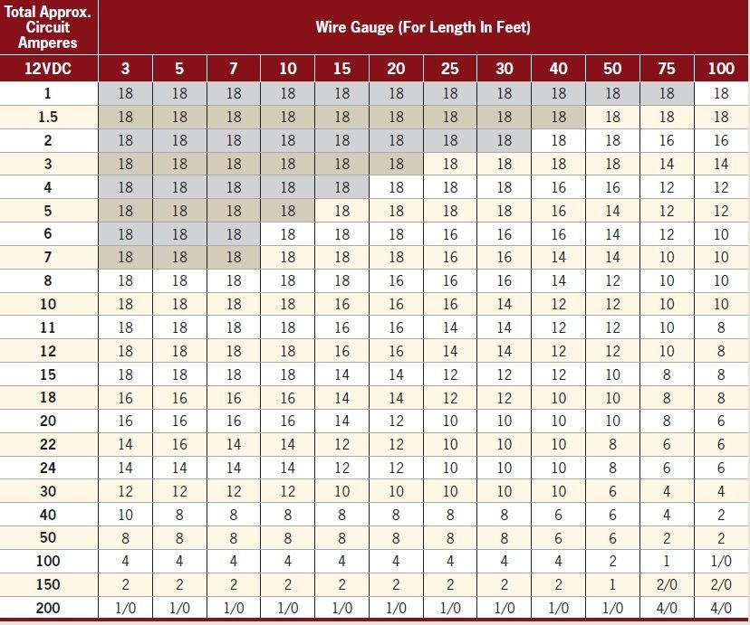

Sorry, I know this forum is old, but I’m going to try and do this fix on my 2008 hunmer h3 alpha. The little blue wire you solder the resistor to. Do you know what gauge of wire it is? Want to know in case I want to rewire it in the future or take the resistor out. It probably doesn’t matter but I thought I would ask.
-thanks
Thicker wires, indicated by lower AWG numbers, have a larger cross-sectional area, which results in lower resistance and higher conductivity. This means they can safely carry more current without overheating or causing damage.
