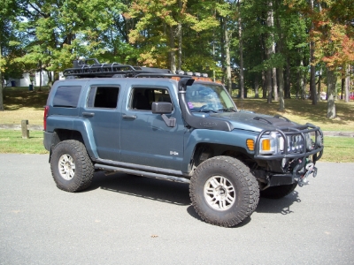

You could also do the torsion adjustment in front and then add 2" longer shackles in back to gain some of the rake back.
In reality 2" longer shackles at the rear of the leaf spring translates into only about 1" at the axle. But it's at least some rake, if that's what you want.
Me = 35" Duratrac's, Torsion bar adjustment, Samco 2" longer shackles in back & Daystar 1" body lift.
