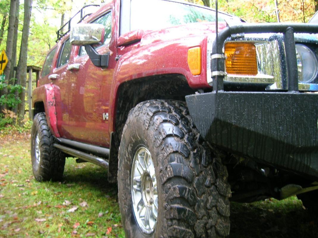

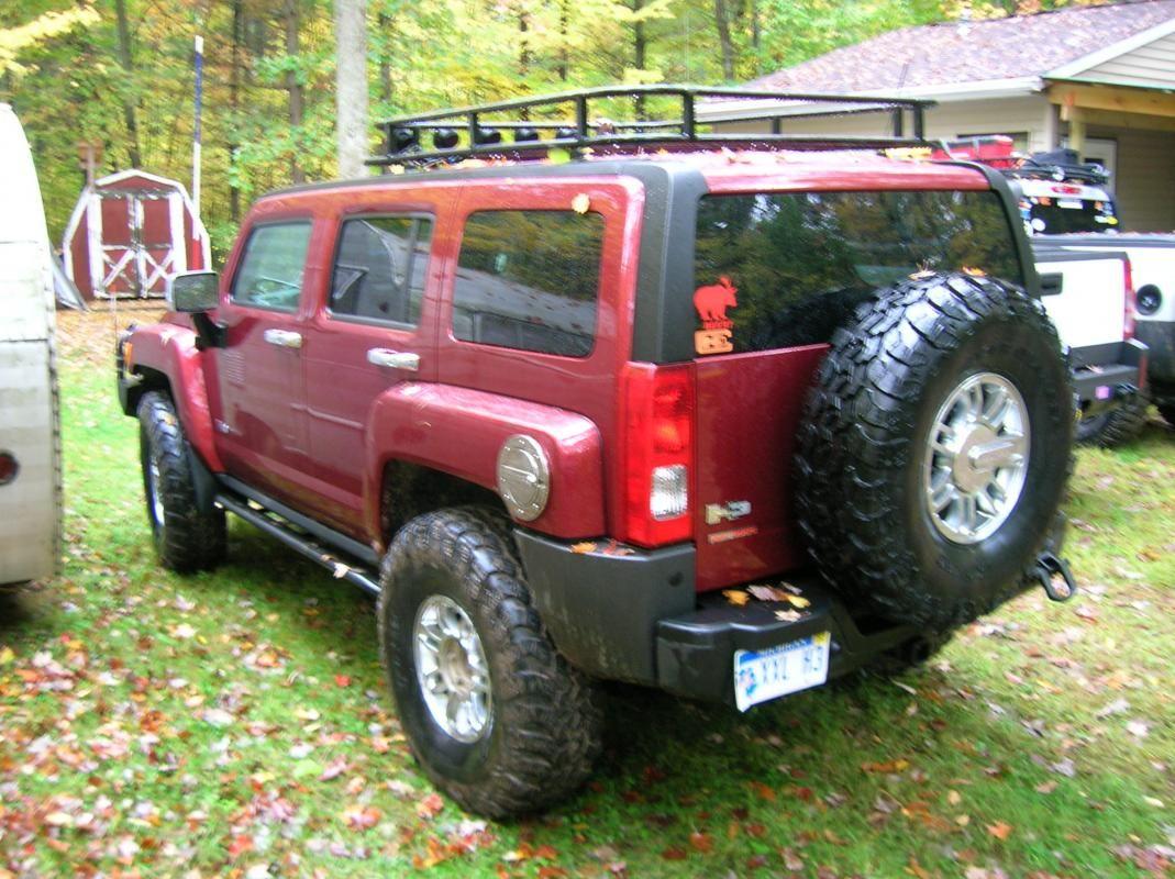

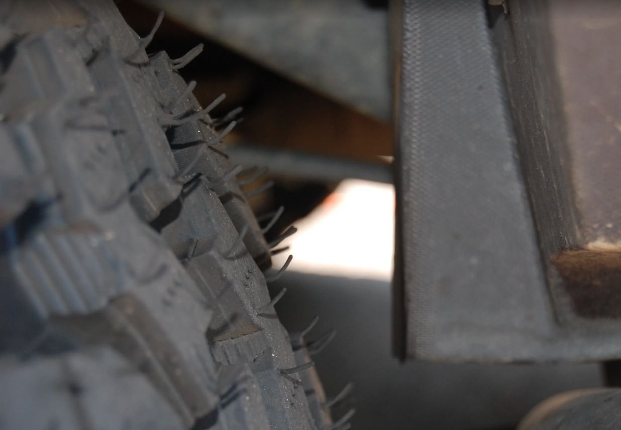

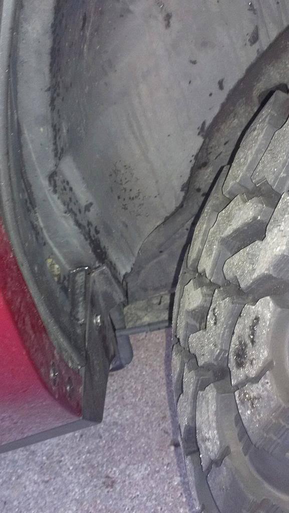

37" tire on OEM 16" wheels will fit on the H3 with a 1" Daystar body lift and trimming of the front inner fender and the rear "shark fin". The removal of the shark fin is a little more difficult as you will have to cut the body seam then weld the seams back together @ the point where they where cut. If you do not remove the fin your tires will rub A LOT during compression. They tuck nicely into the rear wheel well with only slight rubbing on the inner fender plastic at full compression.

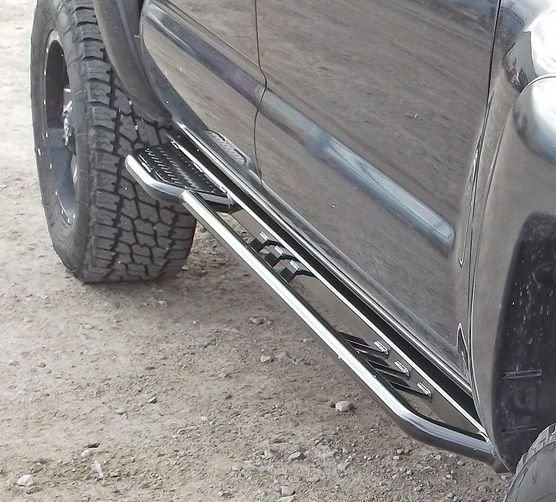

#1 thing I would do is purchase protection. UCP & Rock rails Rocky Road makes them with a rear "kicker" now. I highly recommend them. H3 Rock Sliders: Hummer H3 Rock Sliders, and Kicker rock sliders PM me for the UCP.

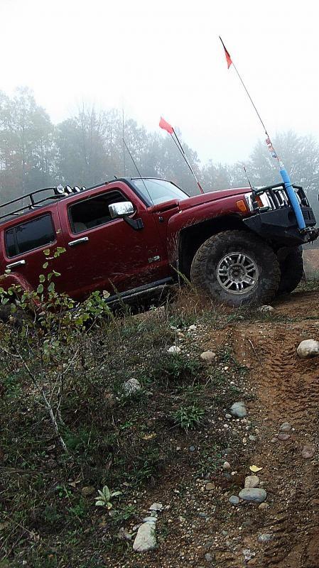

I was wheeling on 37s with a 2010 H3 Alpha OffRoad package for a long time without issues. I would have liked to regar to 4.56:1 over the 4.10:1 stock in the Alpha. Let me know what other information you may need.
2010 H3 Alpha on 37s
"shark Fin"
Shark fin removed
Wheeling on 37s
SPARE TIRE FITS JUST FINE with 1" body lift

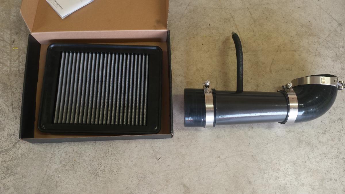

Is there a cai and exhaust you'd recommend? AirDoc CAI for the Alpha Air Doc H3 Alpha Performance Intake System
AFE PRO DRY filter (no oiling, just wash)
, I like the MagnaFlow exhaust. Nice rumble, NOT LOUD and obnoxious.

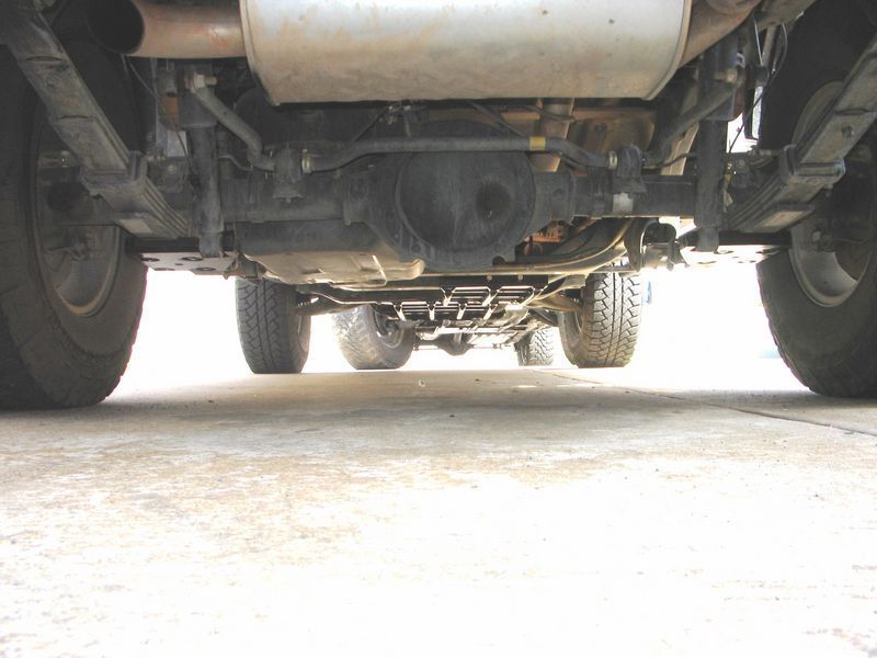

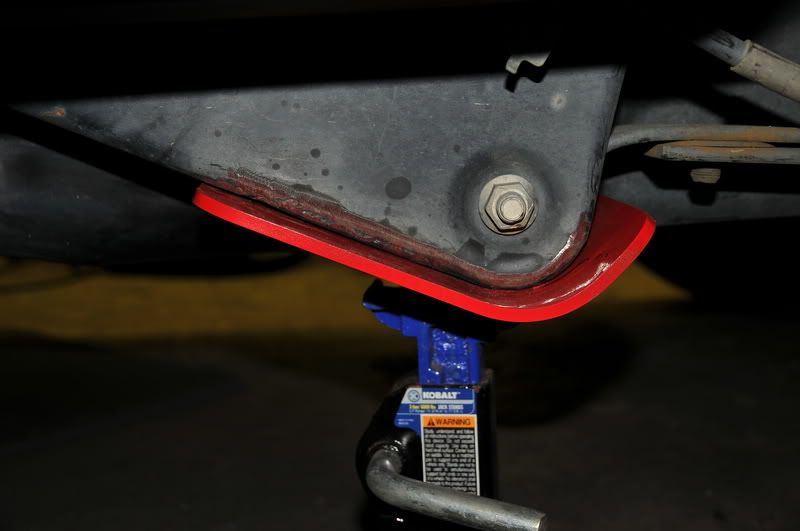

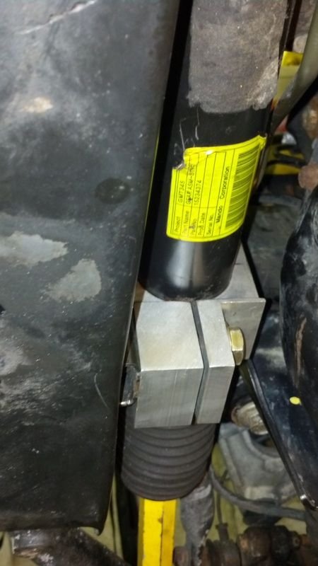

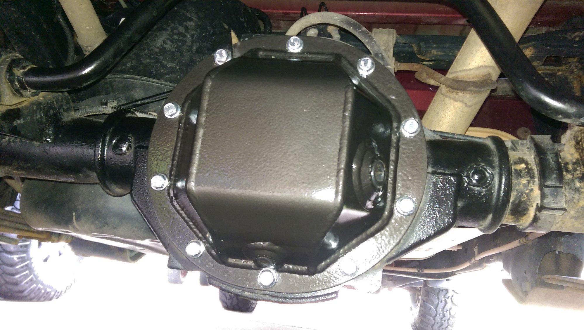

Also I can't seem to send a PMYou have to have 5 posts I believe to PM, but I would definitely like to do some ucp on this as it's practically a new vehicleUCP is vital if you can find it. Several HUMMER owners make different types. Full ladder style (CBPhoto & OEM), smooth belly pan style (Knight Metal Works), etc. .
Are the rear diff I use a 999 OffRoad solid diff cover an have never looked back. https://999offroad.com/product/gm-10...iff-cover-8-6/

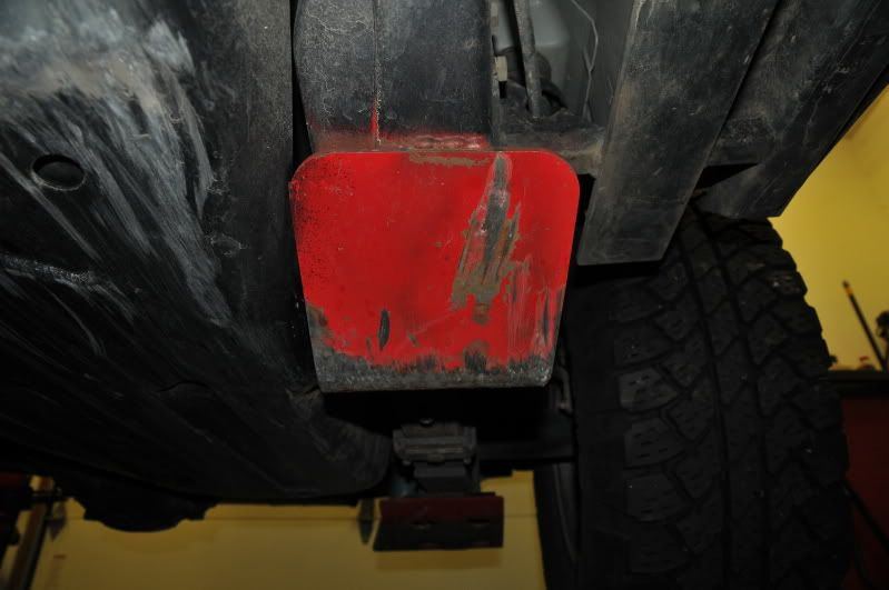

and shock mount skid plates a good investment?In my opinion protecting the front mount of the leaf spring is more important than the shock mount although I have both. I'll see if my buddy has a set of the weld on leaf spring mount protectors left.
Hanger Skidz
Shock mounts, no longer made sorry, but you can see the ladder style UCP in this photo.

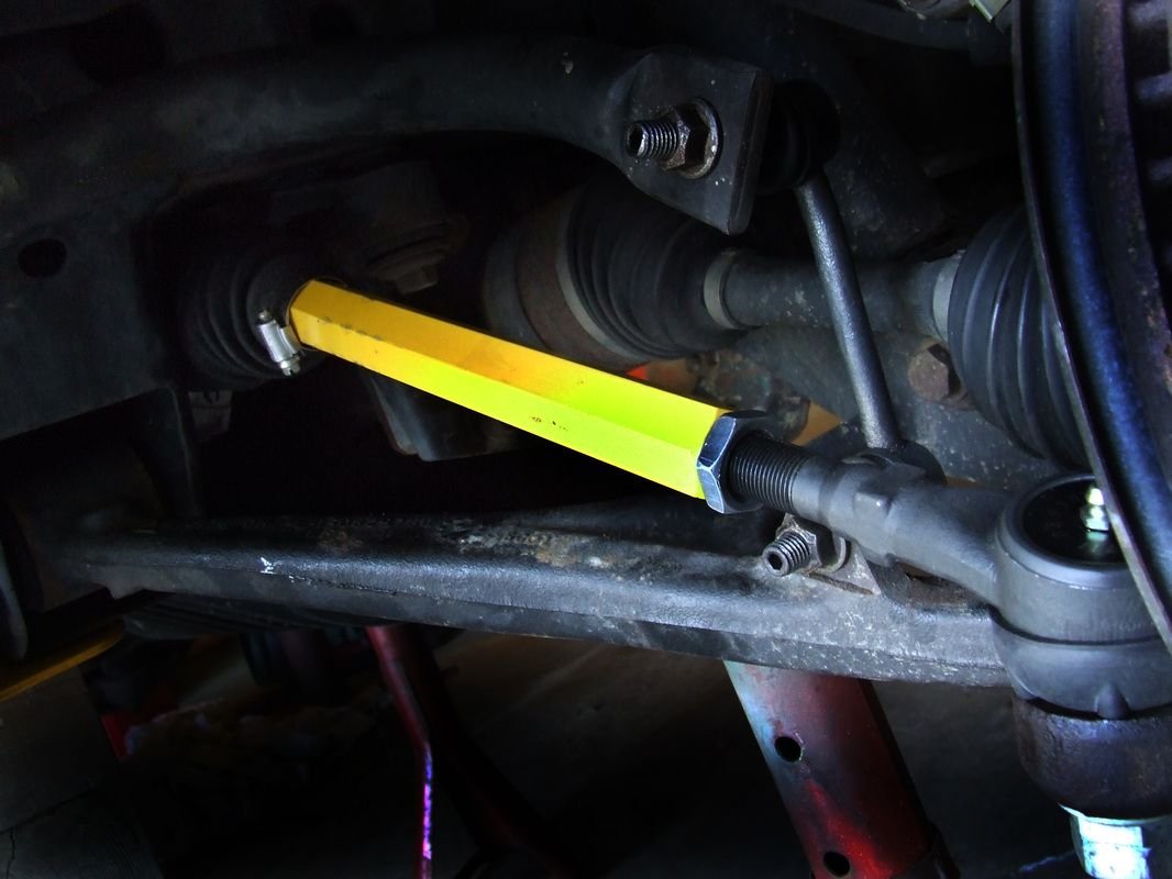

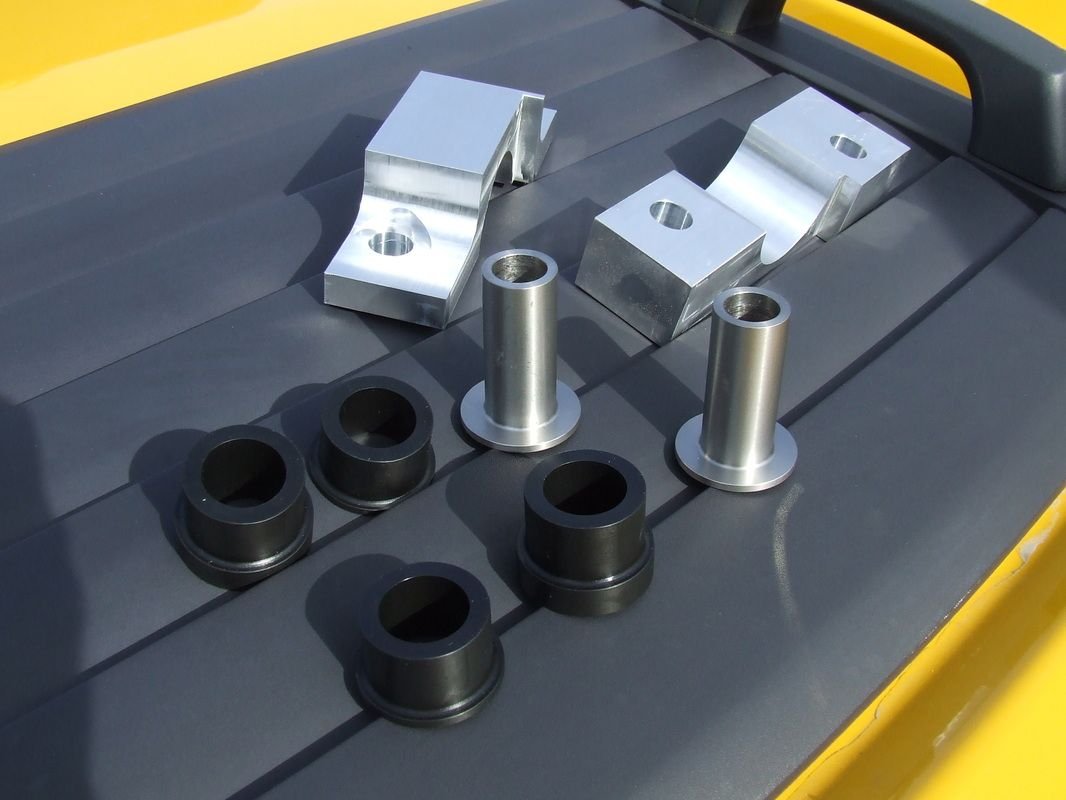

If you are planning on wheeling your H3 Alpha OffRoad with 37s you will want several parts from www.outfitterdesign.com. I have used and abused ALL of the items below and they have held up. In order of importance:
Hummer H3 Steering Rack Reinforcement Kit
https://www.outfitterdesign.com/stee...ement-kit.html

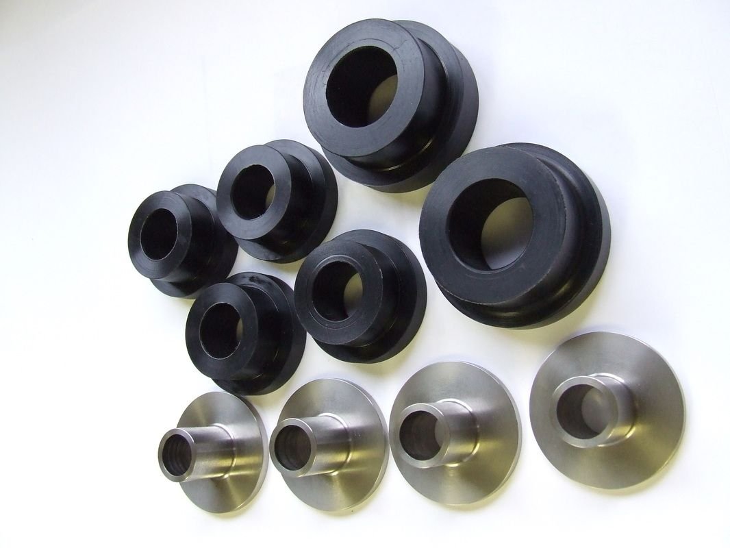

H3 D.I.Y. FRONT DIFFERENTIAL BUSHING KIT
https://www.outfitterdesign.com/do-i...shing-kit.html
HUMMER H3 HEAVY DUTY TIE ROD KIT (BIG AZZ TIE RODS)
https://www.outfitterdesign.com/humm...e-rod-kit.html
