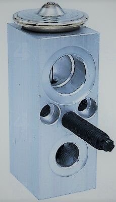

Charged the refrigerant and the gauge kept bouncing into the red and drop to 0 and the clutch keeps engaging and disengaging. One of my friends uncle is a mechanic and they said it sounds like I need a new expansion valve, does that sound about right?
Old May 29, 2020 | 04:26 PM
One of your friends uncle is on to something.
Available at local parts stores(just make sure it looks like the pic I posted above)
or you can get 1 cheap here---> 4 seasons 39313

It's the most common component failure with your symptoms/readings, now your part needs to perform as intended.
Most important is evacuation, swap part asap, vacuum hold, and recharge with the proper amount.
