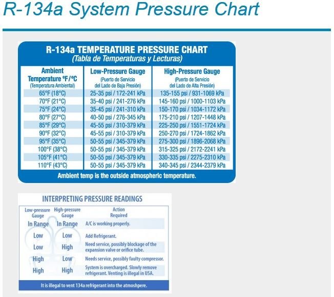

Connect the manifold gauges.

It appears your A/C compressor clutch is engaging. Now, you need to look at the pressures.
