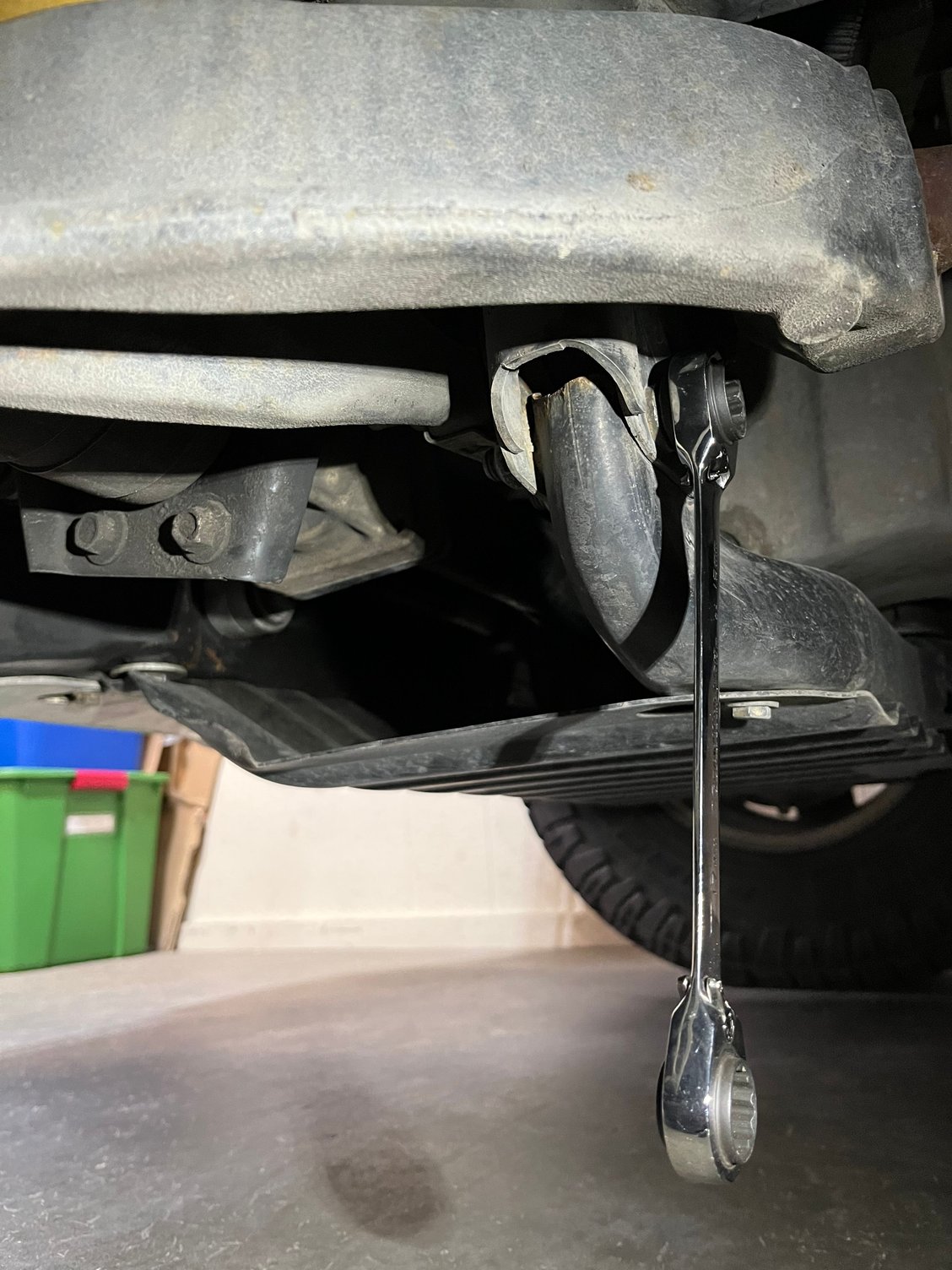

@KU1525 Did you have any problem getting the cross-member mounting bolts out? Were either of the lower A-frame parts in the way? Did you use hand tools to take off the 18MM hex nuts?

@KU1525 Did you have any problem getting the cross-member mounting bolts out? Were either of the lower A-frame parts in the way? Did you use hand tools to take off the 18MM nuts?
No problem with anything in the way. I used a basic wrench on one end to hold it and a socket/ratchet on the other like this setup below. I sprayed some PB blaster on the bolts a few minutes before starting but didn’t have any trouble getting them loose.
