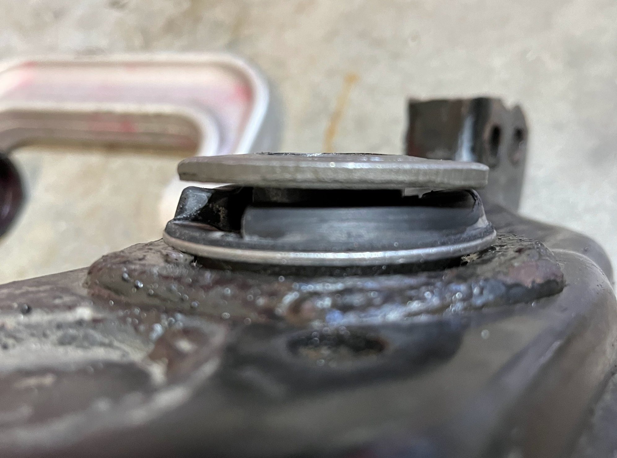

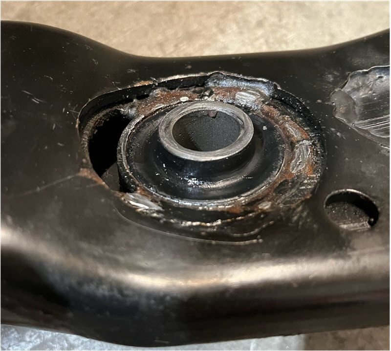

Was able to successfully press the bushing in and take it for a test drive. All feels well and I'm not getting a clunk when shifting. Mine wasn't completely shot just yet but after getting the cross member off, I'm glad I replaced it. @Justinh I got an OEM bushing from Amazon for $17 back in September.

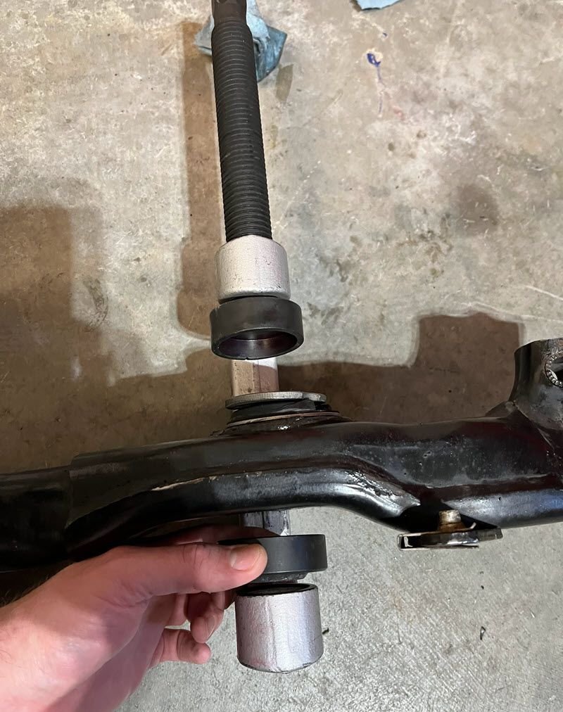

It was definitely a pain not having a press and I would for sure recommend getting it pressed in at a shop if I had the choice. Having said that, I was able to press it in using the ball joint press so just saying it's possible to do without a press AND by yourself. I spent 20 minutes trying to figure out exactly which combination of attachments to use and this is what worked best for me:
ball joint press attachments and setup

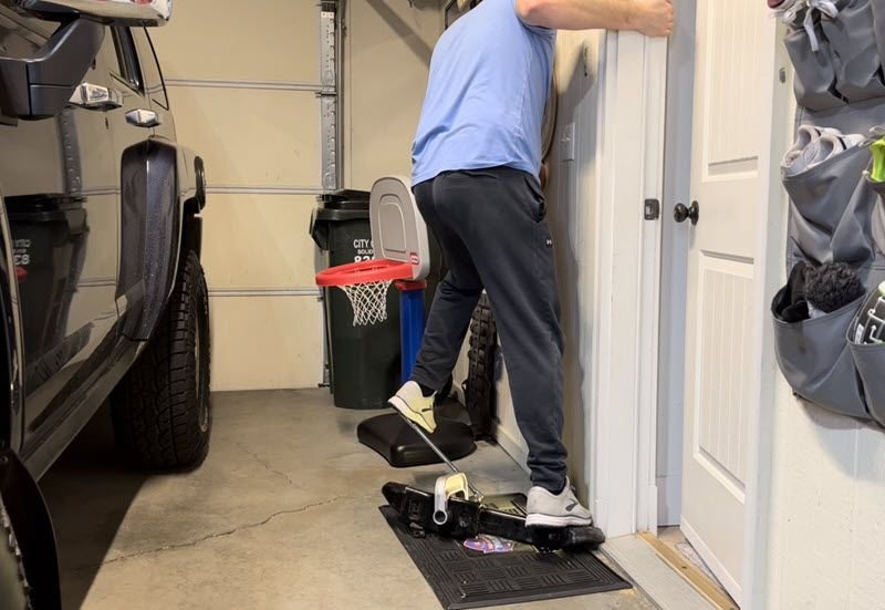

There came a point though where I was not able to continue pressing the bushing in using my hands to crank the breaker bar. I even had my wife stand on the end of the cross member but it wasn't enough to keep it from moving. This is what worked for me **do this at your own risk!**
Ridiculous, I know. But I felt like there was still some left to go in so I used my foot to push the breaker bar and press it in the rest of the way. Most definitely would not suggest going this route but I didn't have much of a choice at that point. Legs are already sore, too. It was a 3/8" ratcheting breaker bar from Harbor Freight and I ended up snapping the piece around the left/right adjuster on the last push. Here's the final result before getting everything installed again:
Thanks to all who made suggestions and good luck to the next guy that goes at it without a press. Just don't forget to grease it well before you start and get the ball joint press from the beginning. Would have saved a ton of time.

yeah, standard ball joint press with a 1/2” breaker bar. Held the cross member in my bench vice. No name bushing off Amazon. No balancing act required. :-)

NO OEM BUSHINGS! Remove/Install with bj press & 1/2" long breaker bar/pipe extension on the handle, or to make it easy (no vise/balancing act needed) use a high torque 1/2" impact wrench!
