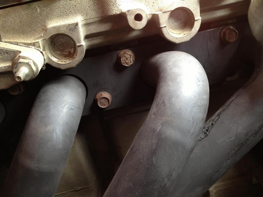

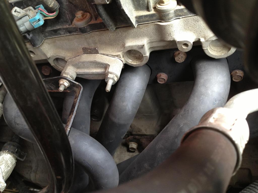

so I have had the parts for some time now but havnt had the time to put them in. I'll be honest, i didnt do them myself. I tried to tackle the steering rack bushing myself but ran outta time so i had to have my mechanic finish it up. its hard for me to find the time to do projects like this...owning a restaurant takes up alot of my time and then i have a wife and daughter that require the rest of my time.
the bushing was a bit of a bitch for me. the bottom bolt was easy once it brok free but the top is in a spot that only allows a half turn of the ratchet each time and theni tried to come at it from the top of the engine bay with an air rachet but every air ratchet i used didnt have enough nut to spin the bolt. it only succeded in slamming my thumb against the frame mutiple times..lol.
But any way my mechanic did the work and he usually does alot of the hard stuff on my h3. He said the header was a real pain. The bolt thats closet to the fire was was completly missing the head on it and then one ended up breaking about half way down and the other came out fine. Luckly he was able to drill them out with no problem and didnt need a heli-coil kit.

here is the pics of the project. i couldnt get any of the install of the header...sorry. i can take a pic of the old manifold if anybody is interested. I do have a pic of the new bushing that went it, i have to resize it first before i can upload it.
