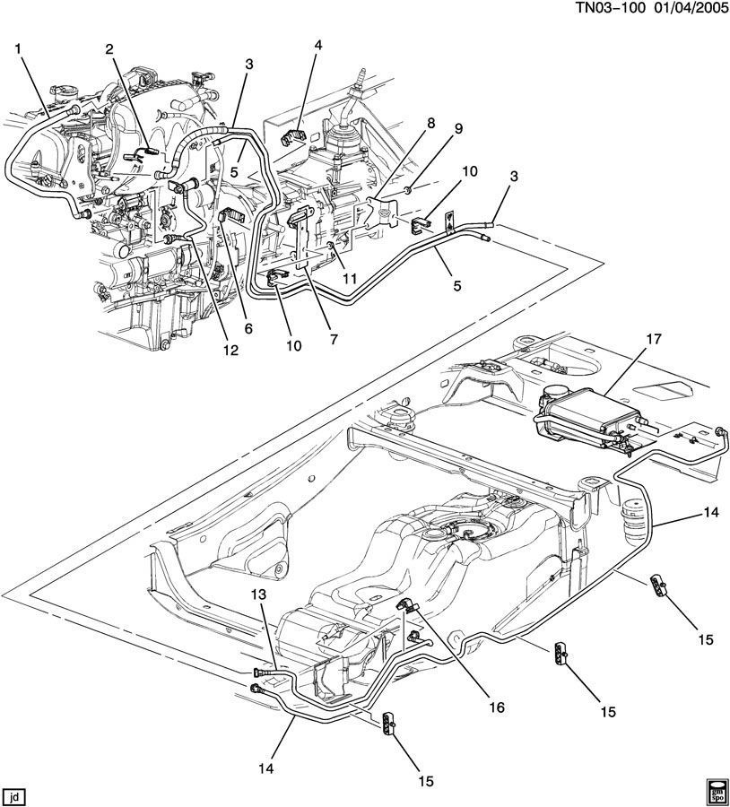

Old Dec 29, 2018 | 03:25 PM
Donald Austin's Avatar
Joined: Apr 2018
Posts: 51
Originally Posted by TAINTER
this diagram is a great help, i couldnt find it on my online manual. is it possible to test the purge valve first before replacing it or replace the vent selenoid first?
