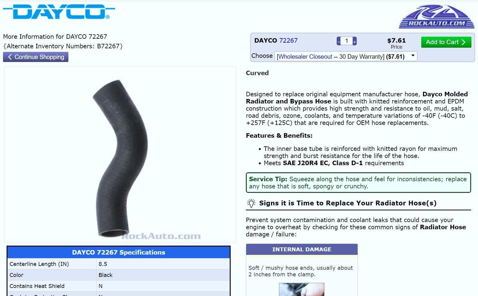

Originally Posted by Justinh
I hear ya, Hummerz, but not this time. Thanks, Doc.
Now I know why the right end gets pushed into the front sheet metal cross-member at the top. The top hose is really too long (horizontally) and it is stiff, especially when pressurized, so it pushes the radiator since it can give at the ends. That top hose needs to be .25-.50" shorter!
Why risk it cheap & easy to replace?
Signs it is Time to Replace Your Radiator Hose(s)Prevent system contamination and coolant leaks that could cause your engine to overheat by checking for these common signs of Radiator Hose damage / failure:
INTERNAL DAMAGESoft / mushy hose ends, usually about 2 inches from the clamp.
Internally Damaged Hose
Internally Damaged Hose LEAKAGEMoisture, drips or coolant bleed marks on or around the hose clamps, connectors or hose.
Leak Damaged Hose
Leaking Hose HEAT DAMAGE Slight swelling, or a hardened, glossy cover that is covered with cracks.
Heat Damaged Hose
Heat Damaged Hose OZONE DAMAGETiny, parallel cracks in the cover, usually at hose bends.
Ozone Damaged Hose
Ozone Damaged Hose ABRASION DAMAGE Rubbing marks on, or damage to the hose cover.
Abrasion Damaged Hose
Abrasion Damaged Hose OIL CONTAMINATION Soft or spongy to the touch - bulges and swelling are readily apparent.
Oil Damaged Hose
Oil Contaminated Hose
