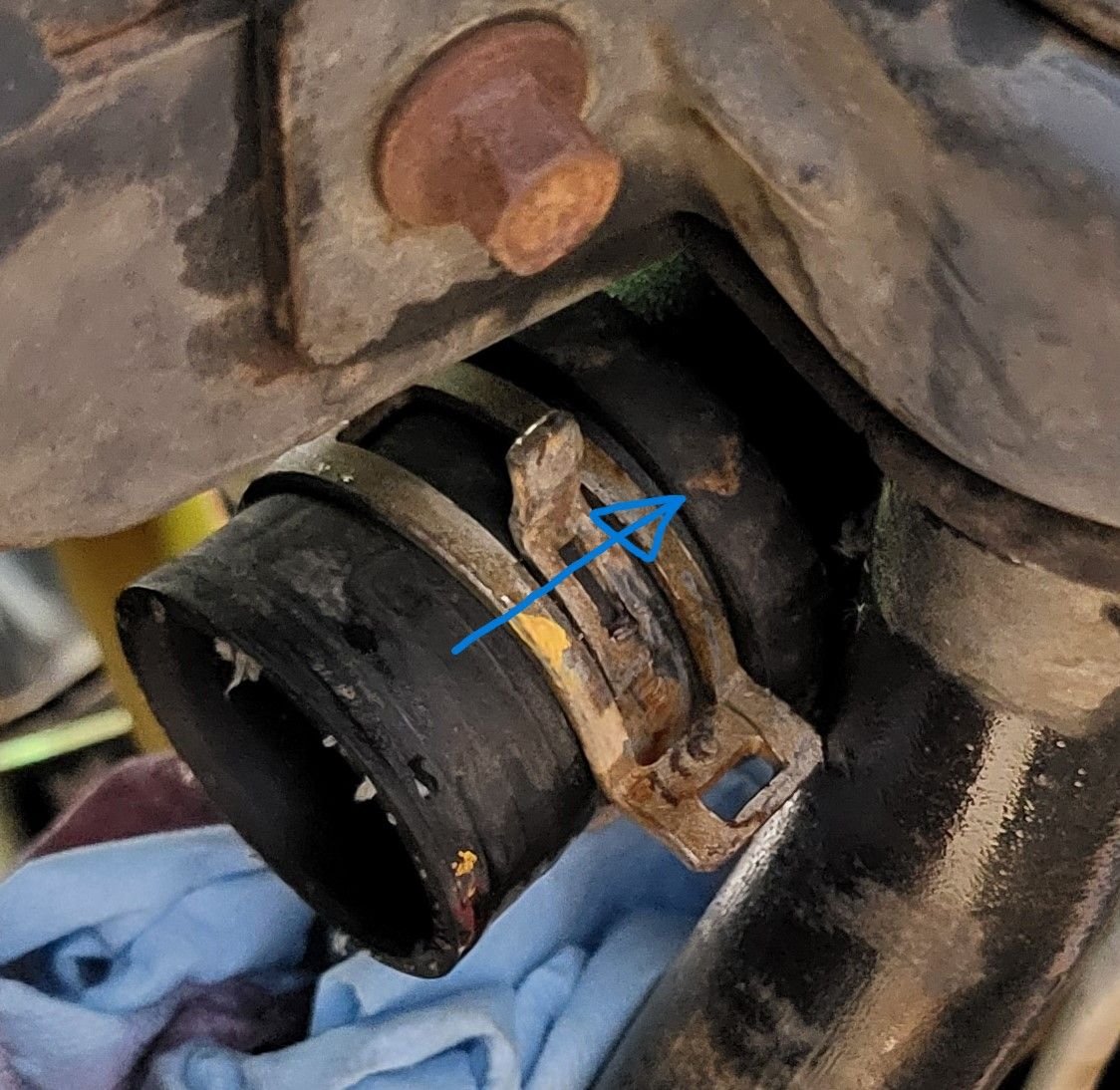

The new lower hose does not have this collar thingy like the original. Does it come off (so it can be put on the new hose)? What is the purpose of it?
No, it is molded in the hose. Purpose is assembly on the line, easy to grab and keeps clamp from moving away from where it is needed to expedite attachment.

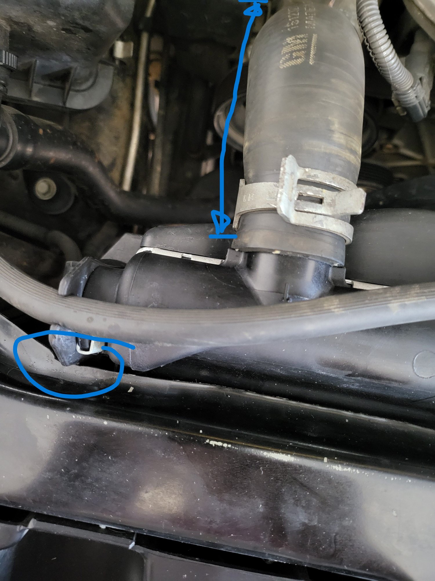

Now I know why the right end gets pushed into the front sheet metal cross-member at the top. The top hose is really too long (horizontally) and it is stiff, especially when pressurized, so it pushes the radiator since it can give at the ends. That top hose needs to be .25-.50" shorter!

probably because it's old and ballooned and it stretched?
