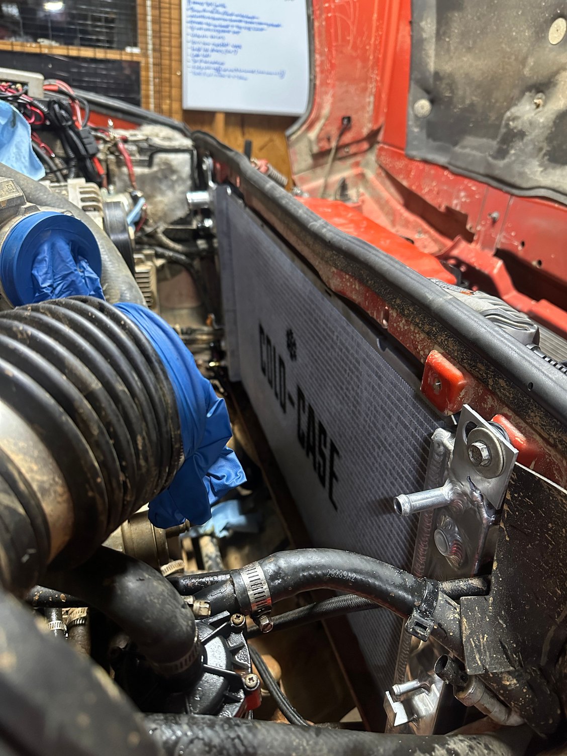

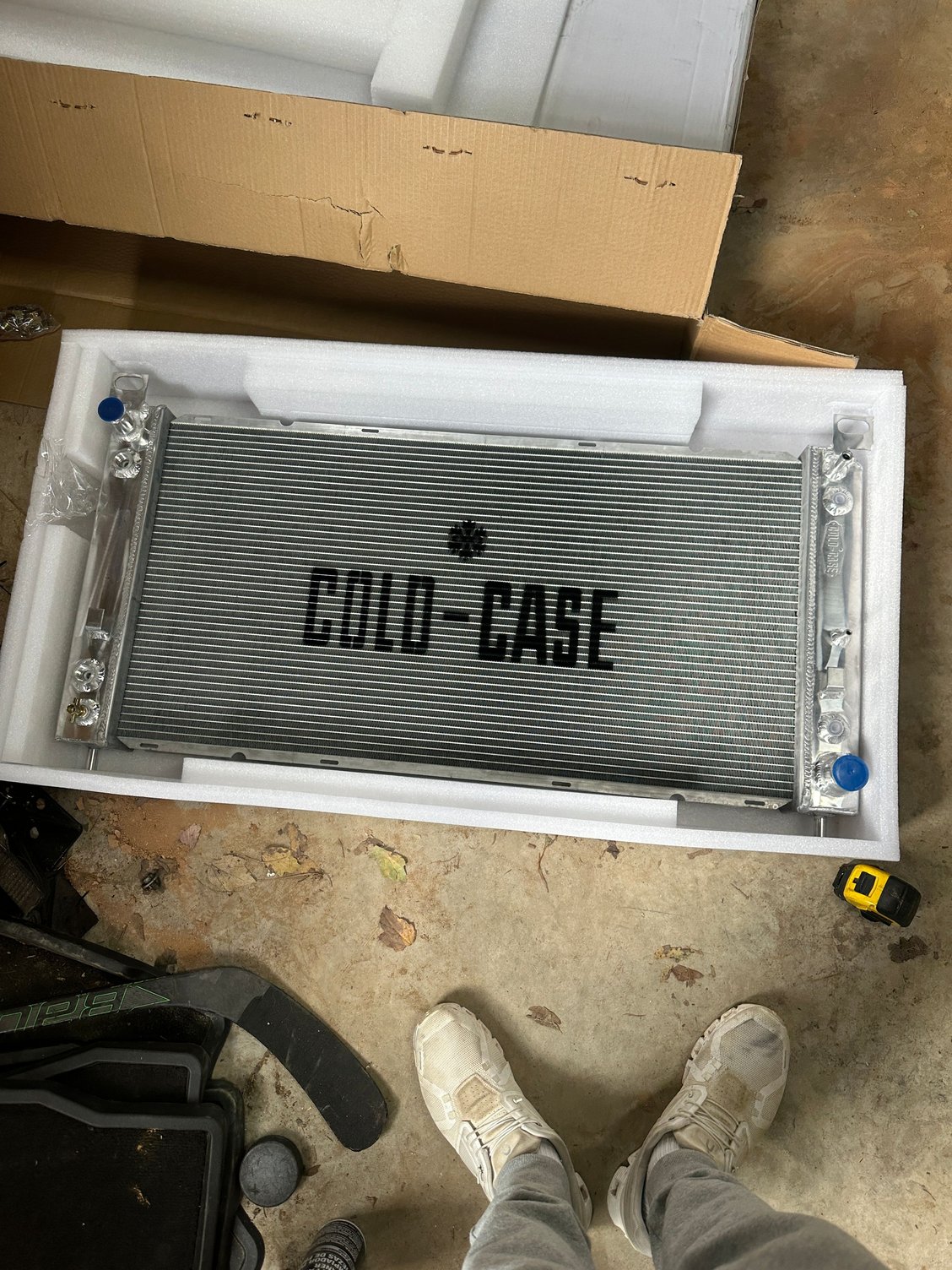

My cold case rad arrived yesterday and I put it in. First impressions are good.
It’s packaged way nicer than the champion. Includes straps to hold the box together and thick foam on either side of the rad. Idk if you can tell in the pictures but there’s footprints on the box yet not a single fin is damaged on the radiator.
I did notice the welds are not as nice as the champion but I’ve seen worse. Also cold case has their logo stamped on the side tanks. This would’ve been done before the tanks were welded, so that shows this manufacturer likely isn't selling the same no name radiator somewhere else.
The fitment is better than the champion. It doesn’t hit the ac condenser hardline on the passenger side like the champion, and the tanks stick out farther on the inside meaning the fan shroud actually fits properly without pressing up against the core. My only complaints are that it didn’t come with isolators for the top or bottom mounts. I had to reuse the bottoms and I found some rubber grommets for the tops. Also I had to grind down the top support bar on the core to clear the two bolts for the condenser.
I was able to reuse my evil energy an adapters for the oil cooler which was nice. Just left the trans cooler side plugged.

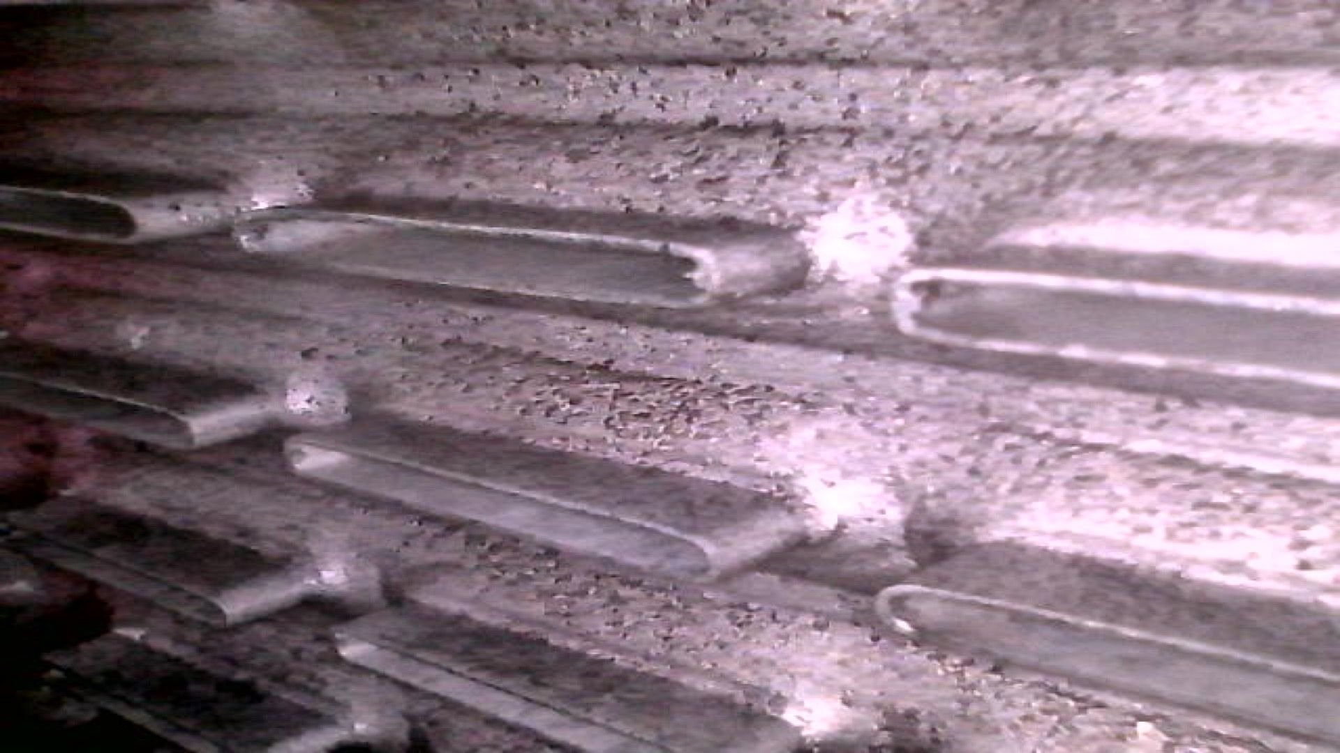

If anyone is interested on the inside of the 3 row champion vs the two row cold case I put a borescope inside them and took pics. You can see the difference in row size. It’ll be interesting to see if one performs better than the other. The oil cooler setup is the same though.
one final thing is that the cold case radiator arrived straighter than both old and new champions. They both had their bottom and top rows crunched in slightly. And coincidentally that’s where the old one leaked. Right at the bottom rows.

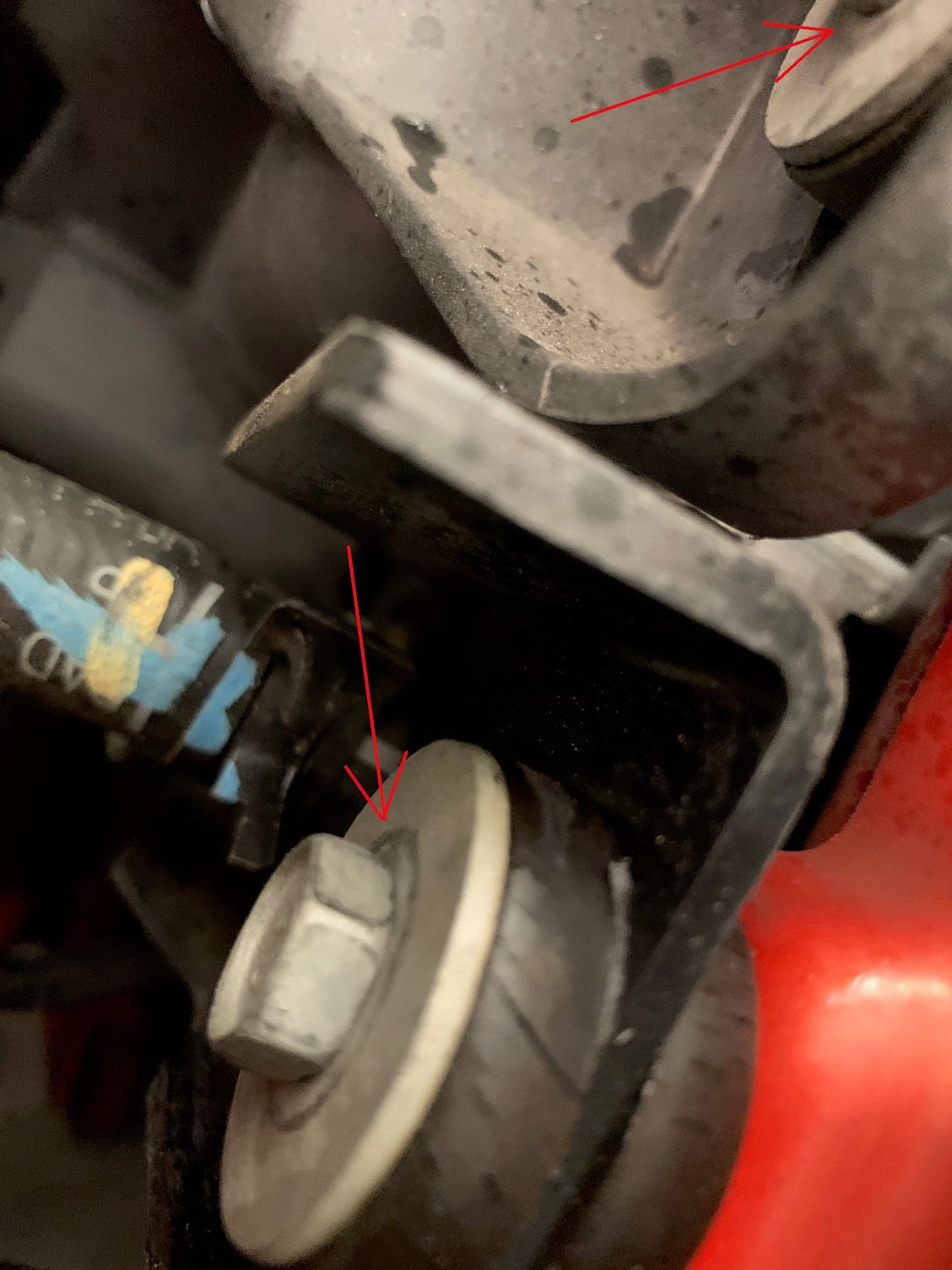

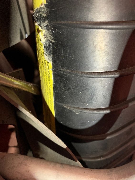

With all that said I started to do some detail looking at my H2 to see how bad this was going to be. Humm? whats this green tag on the tank on my radiator, it talks about stripped threads not being covered under the warranty.
I thought someone's been here before so I started looking closer. I was thinking that green warning tag would not be on a radiator from the factory. Then looking closer I noticed some of the shroud bolts and radiator support bolts have marks on them like they have been off before.
So, I believe someone before me has already replaced the radiator, when and with what I have no idea. I hate to waste money replacing this radiator if it does not really need it. I do wish I could find some identifing marks on it to at least find out who makes it and possibly when it was made. Again, more questions than answers....
