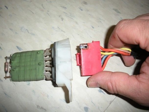

AC/Heat has no blowing (none of the settings 1, 2, 3 or 4 lead to significant air output). Driving down highway, faster I go, more cold air comes out. Suspect compressor is thus still working and blower is issue. Hear a slight whining sound upon acceleration. Voltage reads little to no power reaching blower motor harness (resistor removed per repair manual).
Blower motor resistor replaced under recall at 90K or so. Thoughts on if blower motor replacement is the right place to start (vs HVAC control module or blower resistor)? All fuses tested working. Anything in particular to know about replacement beyond the manual?

No variance in speed = resistor. If you can hear the variance in speed from the blower motor, reply.
Old Jun 27, 2020 | 09:19 AM
Simple things first.
Put 12v power to the blower and see if it spins. If not, it the blower. If so it's somewhere else.
I would also check the blower motor resistor that you had replaced under recall. But that would make too much sense.

no dice on the resistor. replaced again today (apparently the local shops carry)... on to the motor it seems...will keep you both posted...

Did you back probe the connector to verify 12v on the orange wire?
