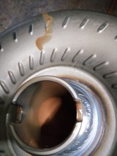

There was a coffee like liquid inside transmission.
Torque converter had to be sent to only place in my country that can open it, fix it, then wield it back together.

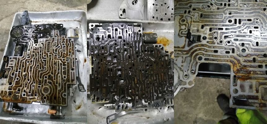

Rest also did not look too good.
Brain had rust in it, gasket was rotten/rusted to the plate, had to be scraped off.

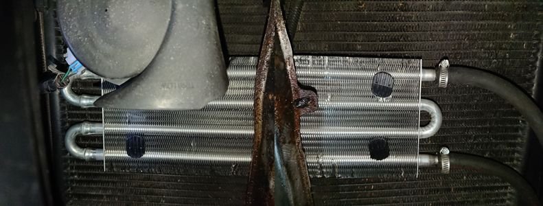

One rebuild kit later, plenty of oil, spit and polish, addition of drain hole:
He also dropped transfer case, replaced plastic fork(for what he was very surprised that there is a plastic parts inside.)
All is back together and car is driving amazingly good, I did not knew H3 could drive so good.
Also, got transmission radiator, no more sharing one radiator.
I purchased car with broken transmission and drove it around for almost a year.
TLDR: get transmission radiator ASAP, comparably little expenses will save so many down the road.
