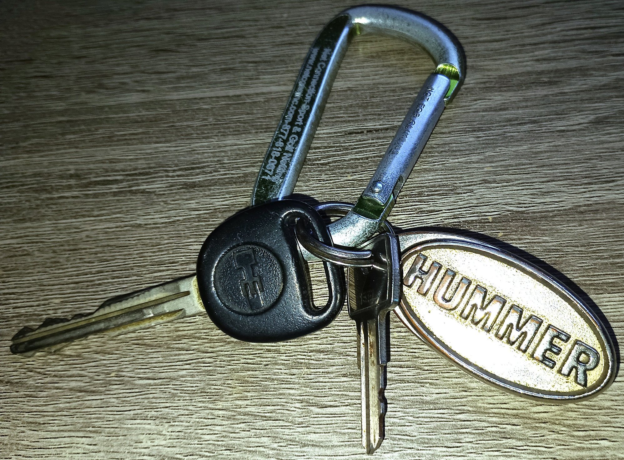

  3. I still carry a key for ignition/drivers door lock + fuel cap lock key:

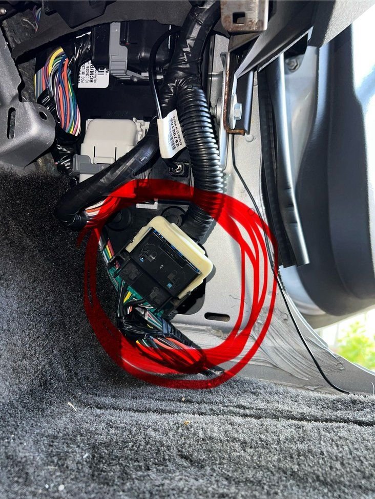

I was chasing the same issue last year and earlier this year, and followed all the same steps as you, but also tried a replacement BCM antenna I got from the local pull n pay and spraying down the BCM circuit board with CRC and letting it dry out.
The thing that fully resolved my issue was when I found and cleaned corrosion in the connector in the harness that runs aft and below the BCM. Not the two connectors that plug into the BCM, but the inline connector in the harness below it. Doing that dramatically changed the remote range from only working right outside the driver door glass to working from three houses down the street, and it's been working like that for a few months now where everything I tried before would only make a difference for days or weeks.

I cleaned the connector you (NMH3) referenced above...just to cross another action item off the list. I was praying for a miracle but nothing changed. I wish the issue was the antenna but everything there seems to be in good condition. A couple months ago I was even able to lock/unlock without the antenna connected as long as I held the FOBS near the BCM. I can't even do that now so I don't believe a longer antenna will make any difference. Does anyone believe the FOB/BCM lost programming and having them reprogrammed would make any difference?

Sorry that didn't work for you. For me, when I opened up that connector I could see corrosion on the pins and internal connector face and was thrilled that everything started to work again after I cleaned it with CRC.

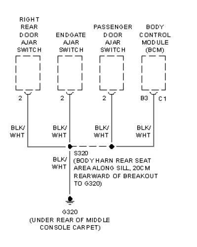

If that hadn't of worked for me, my next step was going to be to find and clean the "G320" BCM ground connection under the rear of the middle console carpet. Not sure exactly where it is, but that's how its referenced on the wiring diagram. It seems to be the only ground dedicated to the BCM itself, vs. an input to the BCM from a related system. That ground stud is also associated with the two right doors and the tail gate door ajar switch, so if those ever don't work properly I would definitely dig into that more. The BCM antenna is certainly going to be more sensitive to a poor ground than a door open switch.
