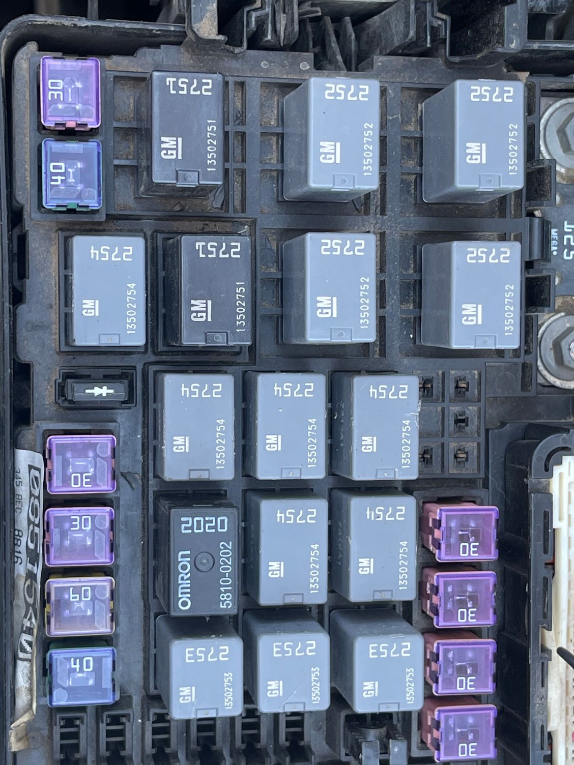

Quick question. Does it matter the orientation of a relay in the fuse box. Can they be installed wrong? I understand the basic functions. I have been reading other posts on how to check if they are good or bad by applying +/- to it and listening for the click then reading across the other terminals. Maybe mine are installed wrong. I did remove the chime box and stereo last night, POS. Still have not ordered the PCM from eBay yet. Just researching every possibility. TIA.

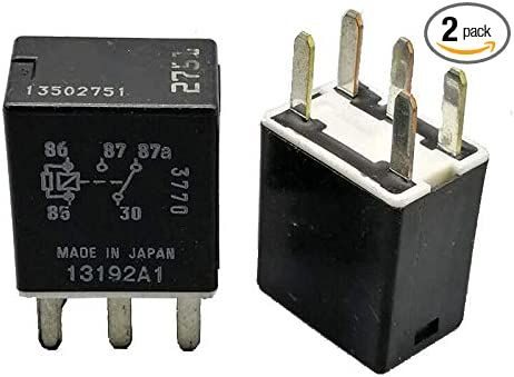

Not sure what relays you have, the oem 58100201 & 58100202 are 5 pin, with 5 slots in the fuse box, therefore can't be reversed.

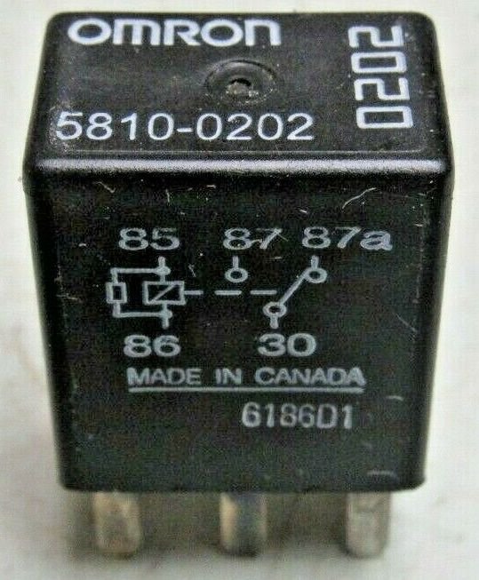

This is what is in mine. I only have one relay with 5 legs.

Same and mounted correct.
85 & 86 are the terminals connected to the relay coil (the relay control circuit) and 87 & 30 are the terminals connected to the switch contacts (the relay load circuit).

I stated yours are mounted correct. Like reading a book, the mega fuse is at the right lower corner, and all relays are mounted with the name on the top and part number on the bottom, 86/85 left side and 87/30 right side.
