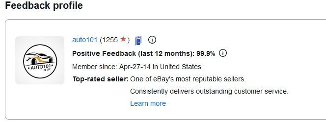

Would you trust this place on eBay? Price is very good for sure. Also, does this need to programmed by the dealer or is it plug and play?
Old Apr 18, 2021 | 11:56 AM
Posts: 9,014
Did you read the listing?

Yes I read all of that. Thank you! Does the H3 need the crankshaft variation relearned
Old Apr 18, 2021 | 03:05 PM
Posts: 9,014
Again, did you read the listing?
"it may need crankshaft variation relearn (code p0315)."
You have been chasing issues since the aftermarket stereo installed. Did you remove the stereo and recheck? Maybe too late? Btw, the seller has a great reputation, and has sold thousands of modules, also from the great state of O-H-I-O. Just make sure, first to verify service number on your pcm, then during purchase, before you checkout, to add a message to seller which includes your vin.
