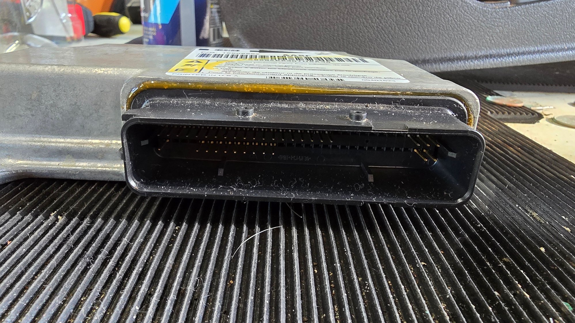

airbag light on scanner can't communicate with module

Here is what it looks like

One more question, should I use dielectric grease to seal the pins to the airbag module? I do have a sunroof so I am assuming it will leak one day. I wonder why GM didn't use any in their connections.
I ALWAYS clean/seal connectors/contacts with dielectric grease!

did you replace the fuse yet?
maybe the module is fine but the power feeding it is bad or shorted. check for power at its pin while you have the module out.
just dont flip the module when it is connected in the car. it has a roll over sensor.

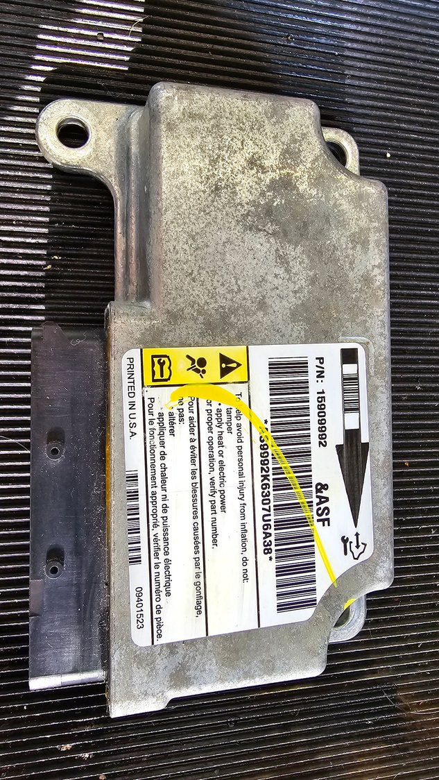

what is #7 in this diagram?

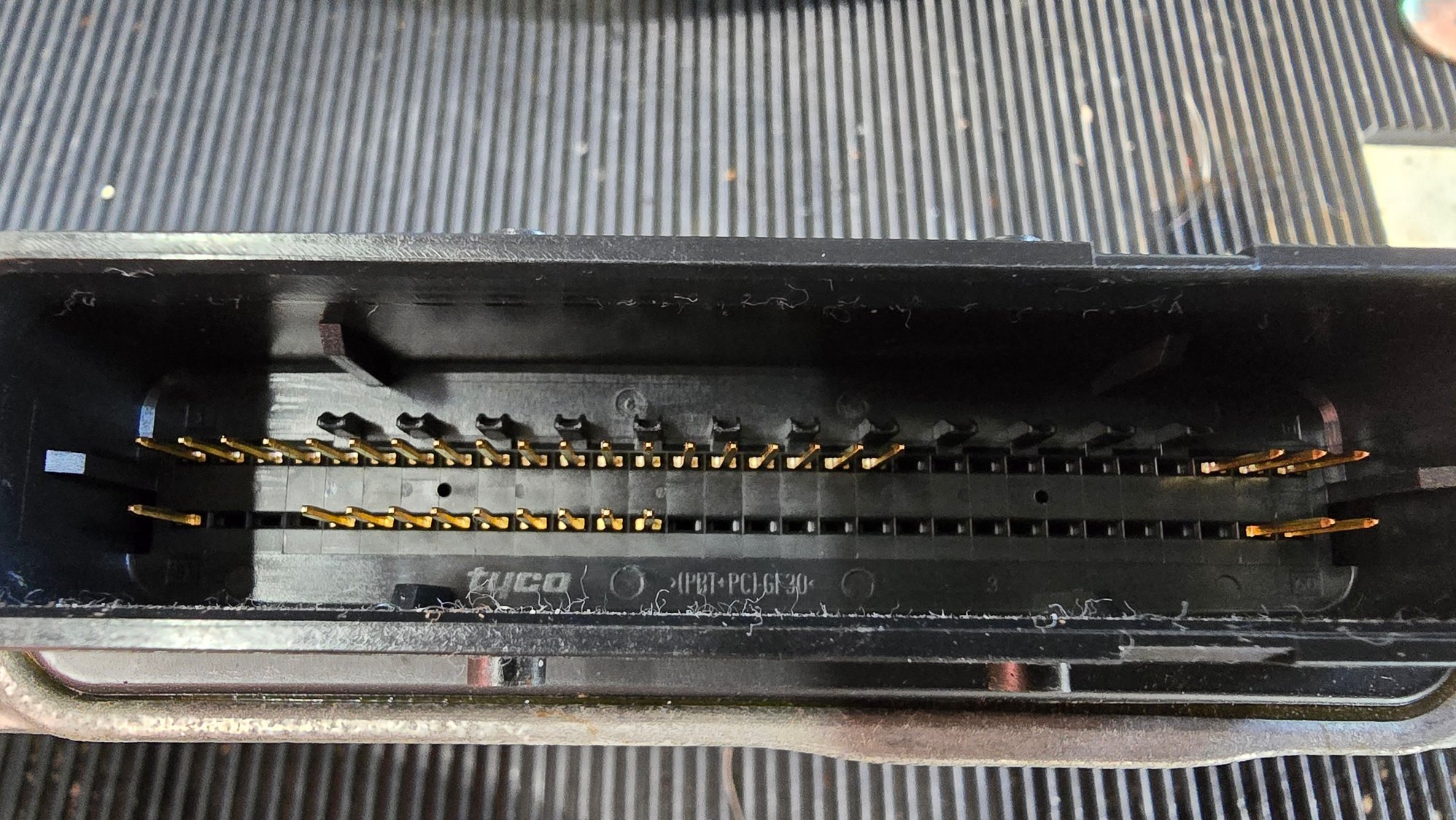

After taking both modules out cleaning them and their plugs and putting dielectric grease in the plugs, I am happy to report the scanner now reads the error codes and is communicating with the module. Thanks for all you help with this issue.
Inflatable Restraint Vehicle Rollover Sensor (ASF) More information here>> Supplemental Inflatable Restraints - H3
