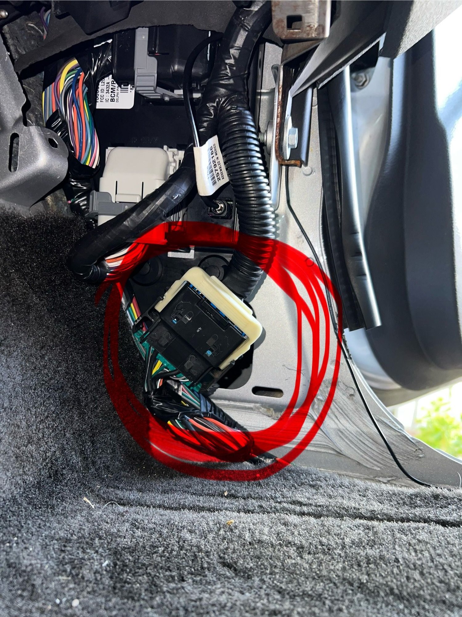

I recently ran into a similar issue. Tried a “new” pick ‘n pull antenna with no change. Removed the BCM, cleaned the connectors (battery disconnected!) and sprayed the board with CRC. No change.
I then disconnected the bigger inline harness connector below the BCM and found corrosion on several pins. CRC’d that and it resolved my SERV TPM error and restored my remote range to 100+ ft. Been a couple of months now and the problems haven’t come back so keeping my fingers crossed this was the root cause if my poor remote/SERV TPM problems.
Make sure to disconnect your battery before spraying this and BCM connectors as there are always-on power lines in those connectors!
CRC clean this connector for BCM antenna problems
