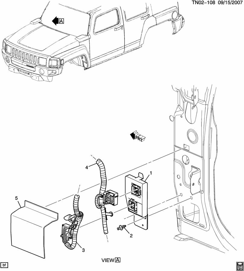

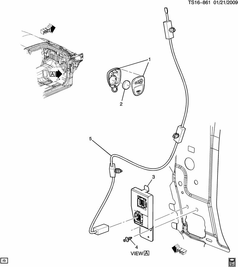

Old Feb 25, 2013 | 08:53 AM
Posts: 9,047
passenger side kick panel..
Old Feb 25, 2013 | 02:21 PM
LifeIsGood's Avatar
Joined: Jan 2013
Posts: 46
Great pics HummerZ. Is Item 5 in the second image the radio antenna? Does it also server as the antenna/receiver for the RKE? Not sure what to glean from the first image. Is there a legend for the items identified in the images?
LifeIsGood
Old Feb 25, 2013 | 09:10 PM
Posts: 9,047
Both images showing the Body Multifunction Electric Computer- The Door Lock Remote Control Inside. (box with the 2 plugs, #1 diagram 1, #3 diagram 2). 1st pic shows the wiring harness connector and cover, 2nd pic shows the antenna + connector(#5) which appears to be separate from the radio. Remove your passenger side panel and take a look. Could be water intrusion/corrosion causing your problem?
