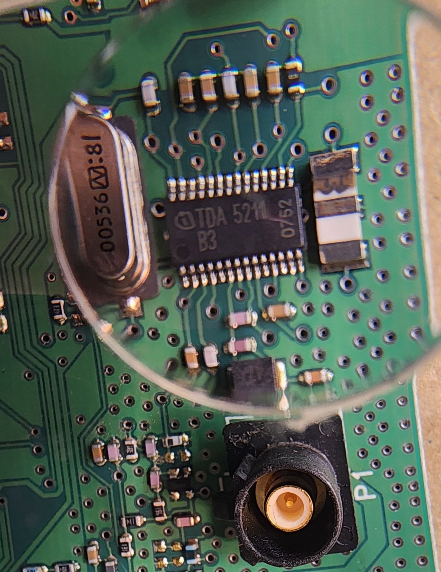

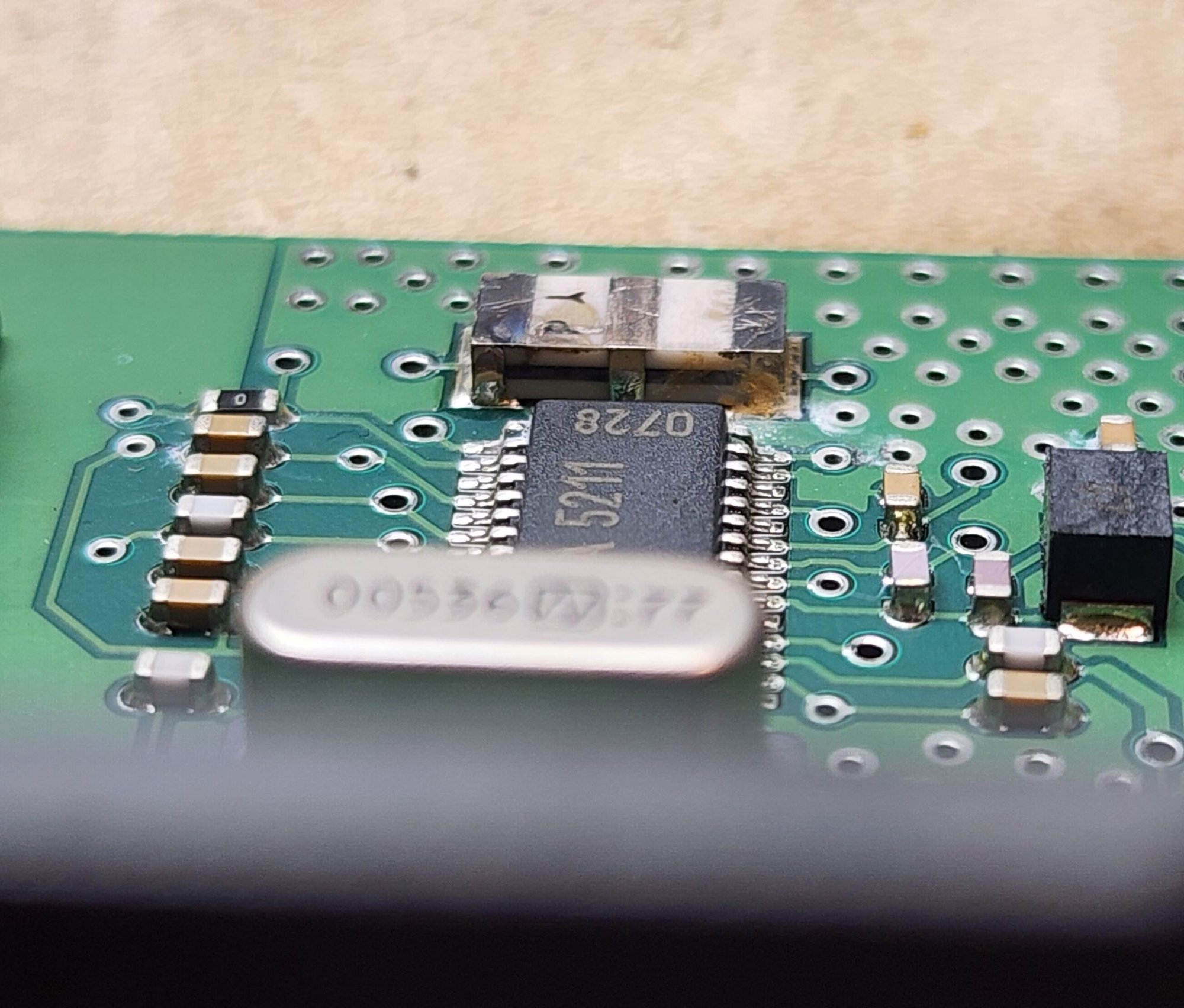

Hi again. I'm still struggling with the lack of communication between key fob and BCM. I ordered a "Used BCM" from eBay and have yet to have it "Flashed" by the dealer (next week). In the interim I opened my original BCM and inspected the circuit board. I found a section that seemed either corroded or burnt (see pic). I took a fine needle to clean around the area - lightly scraping the corrosion off and then cleaning that area with electronic lubricant/cleaner. Because I have no schematic, I have no idea what this section on the board pertains to in the BCM's functions. I also checked on the "Used eBay" BCM (un-flashed) that I bought and found a similar but not as obvious burn/brown mark on the top of the same component (see Pics). I tested for "continuity" but am not ever sure if this component should have continuity (which it did). I re-installed the BCM, but had no luck in creating a com link with the fobs. However, a new problem surfaced. After shutting the engine off with the key and manually locking the doors, within minutes the horn starts pulsing. Then the only way to stop it is to put the key back in the ignition and start it up again. But as soon as I shut it off and close / lock the door, within a few minutes the horn alarm goes back on. Once the the engine is running, the vehicle operates / runs fine. It's only when the engine is off and the key removed that the horn starts cycling again. Since the start of this problem, I've noticed a distinct smell of (as my brother says) wires burning within the driver's compartment. There's never any smoke, and I'm fairly certain it's not coming from the BCM. So what might I be overlooking behind the dash that's related to "fob-com - horn-alert" and could be causing this smell? Something within the Ignition circuit? On Star? or the radio? What else is back there? Thanks!
This is my Original BCM circuit board. The component at the top and o its right are questionable.
This is the eBay "used" BCM yet to be "flashed" at the dealer. Again, the component in question is top-right. Maybe this is normal?
