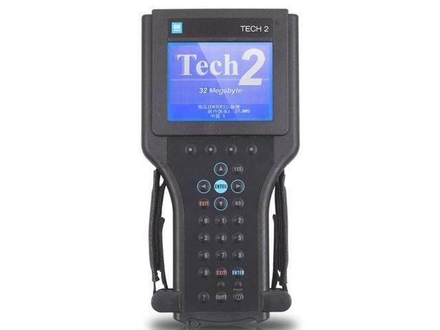

Did your "gm tech" use a TECH 2?

But.............. you have not confirmed they used a Tech 2?

did they set up the programming as a replacement or just an update. you have to tell the tech 2 or programmer in SPI to set it up as a replacement then it asks to confirm the vin number at which point you put in your vin number before it reprograms. if you do not set up that option then it will just update to latest firmware without the vin change to the bcm.
