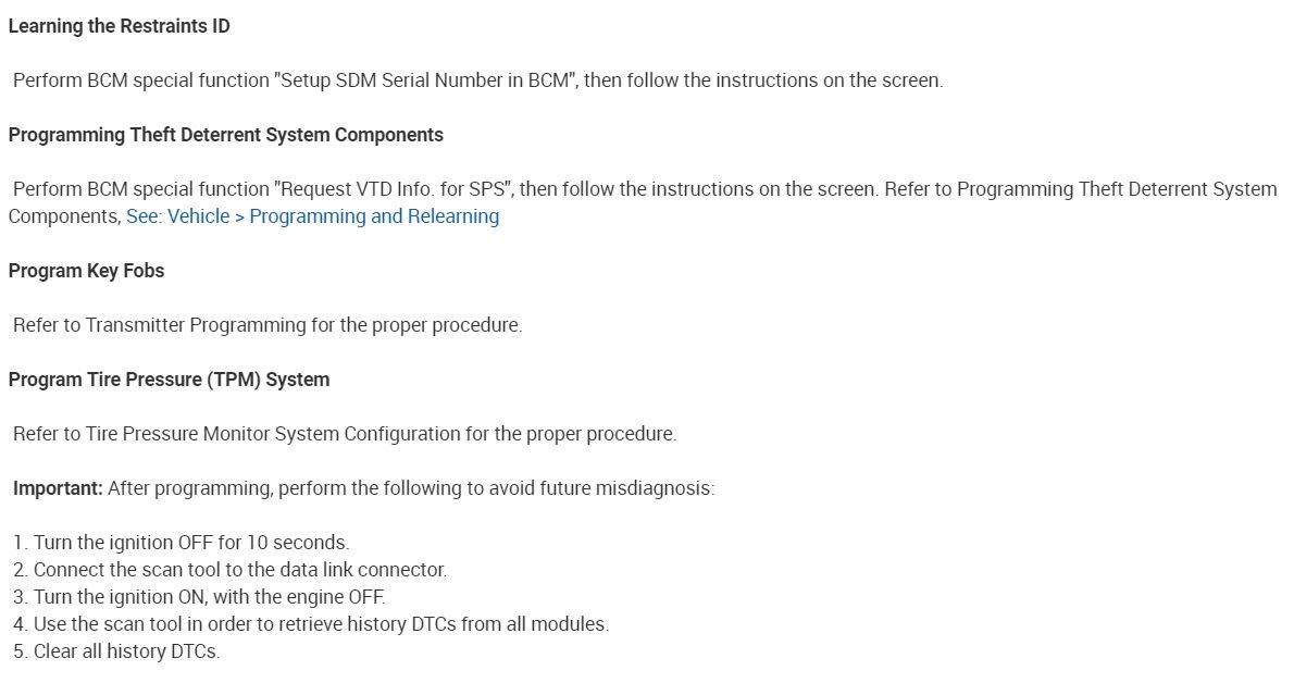

The body control module (BCM) calculates the mileage based on the vehicle speed signal circuit
from the powertrain control module (PCM). The BCM then sends a class 2 message to the IPC
indicating the value of the odometer.
If the actual mileage that is stored in the BCM is greater than the value stored in the IPC, the odometer reading will not update until mileage that stored in the BCM is reached.
Old May 20, 2021 | 03:29 PM
there might be a vin mismatch between the BCM and cluster. so you might need to have them reprogram the vin on the most likely used BCM
it should then give you your mileage counter back
I think you are onto something know that we know the clogged sunroof drains killed the original BCM.. I have not done it, but others have said you can plug and play a used BCM and it may work if from the same vehicle & year etc.... but if the used Vin had higher miles, the Odo won't change until they match miles.
Yep, used BCM.....
