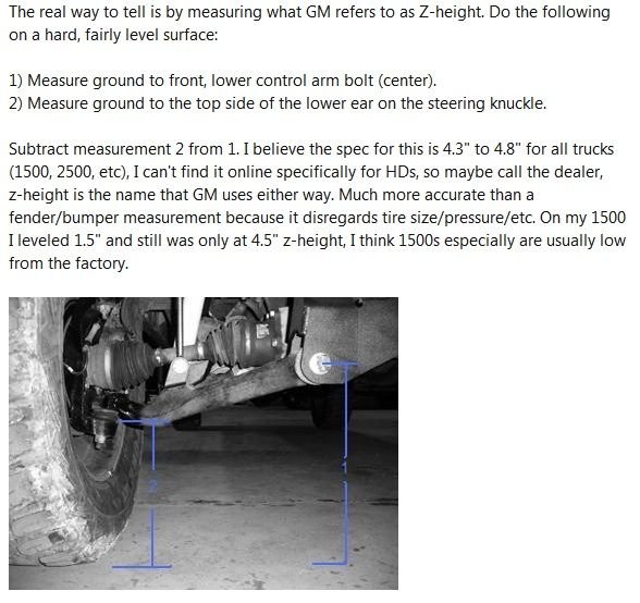

Hi, I have heard that as well, my 06 with air suspension had about 1/2 inch clearance and it rode really well. The 08 (rear coils) are resting on the bump stops, the 08 without a doubt does not ride as good so I thought this might be the issue.
I would like to know if there is a factory spec on this. I do plan to replace the factory GM front shock with some new Bilsteins ( I had them on the 06 and they were really good) Either way I need to get my hands on a set of service manuals to
get this answered once an for all. I also need to find the Z height specs for the H2 to properly set the front suspension height (See attached picture, this is for a 4wd GM truck)
GM Truck ZHeight adjustment
hey i have the service manual if you need it. let me know, i can zip it and provide a download link for it. its 16,000 pages i believe.
