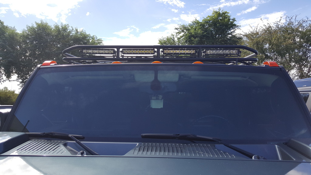

Finally swapped all my junk lights for LED bars. Things are pretty bright compared to what I had up there. I still need to get some night pics.

Lojac, I sent you a private message. When you get the chance can you take a look? Nice set up. I had a gobi rack on my truck with some round pia lights but I like opening my sunroof so I traded it to Citiboy for 4 roof rails and a lightbar. I now just purchased one of those hummer roof rails with the lights already built into it. Waiting on delivery.
