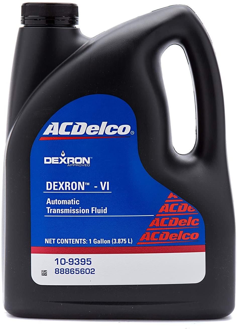

Many here quick to spend your money. Transmission slipping diagnosis, includes dropping the pan. You have an intermittent condition, which can be caused by fluid/flow/restriction. Take it to a reputable shop and ask them to drop the pan and inspect. If debris is not excessive, have it flushed with gm recommended DEXVI+install new filter/gasket. After, you can decide to sell or not. GL
