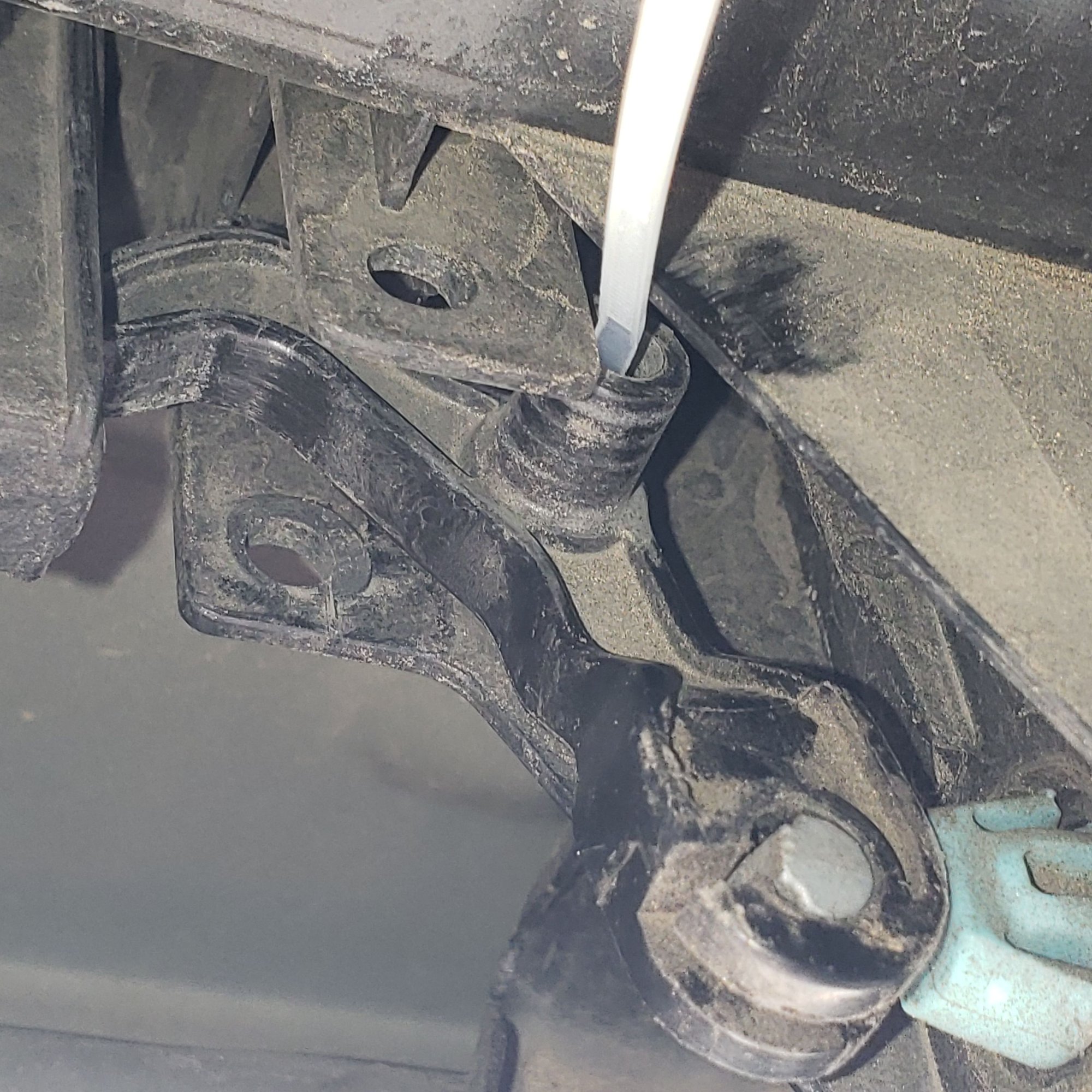

Hi All-
Can anyone please tell me where to order the pin which secures the handle to the unlock mechanism. I'd rather not buy the whole handle kit.
It's the pin which goes through the handle, and the hole which is pictured with a zip tie stuck in it. Also the pins in the full latch kit screenshot which is attached.
Thanks!

if you still have the pin you can just get the C clips. it might still be inside the door if it fell off. or just get a long enough bolt with a nylock nut.

Further to what Bronxtech said, U can use a thinner bolt with a steel sleeve (readily available) to avoid the threads chewing plastic. Washers at both ends.
