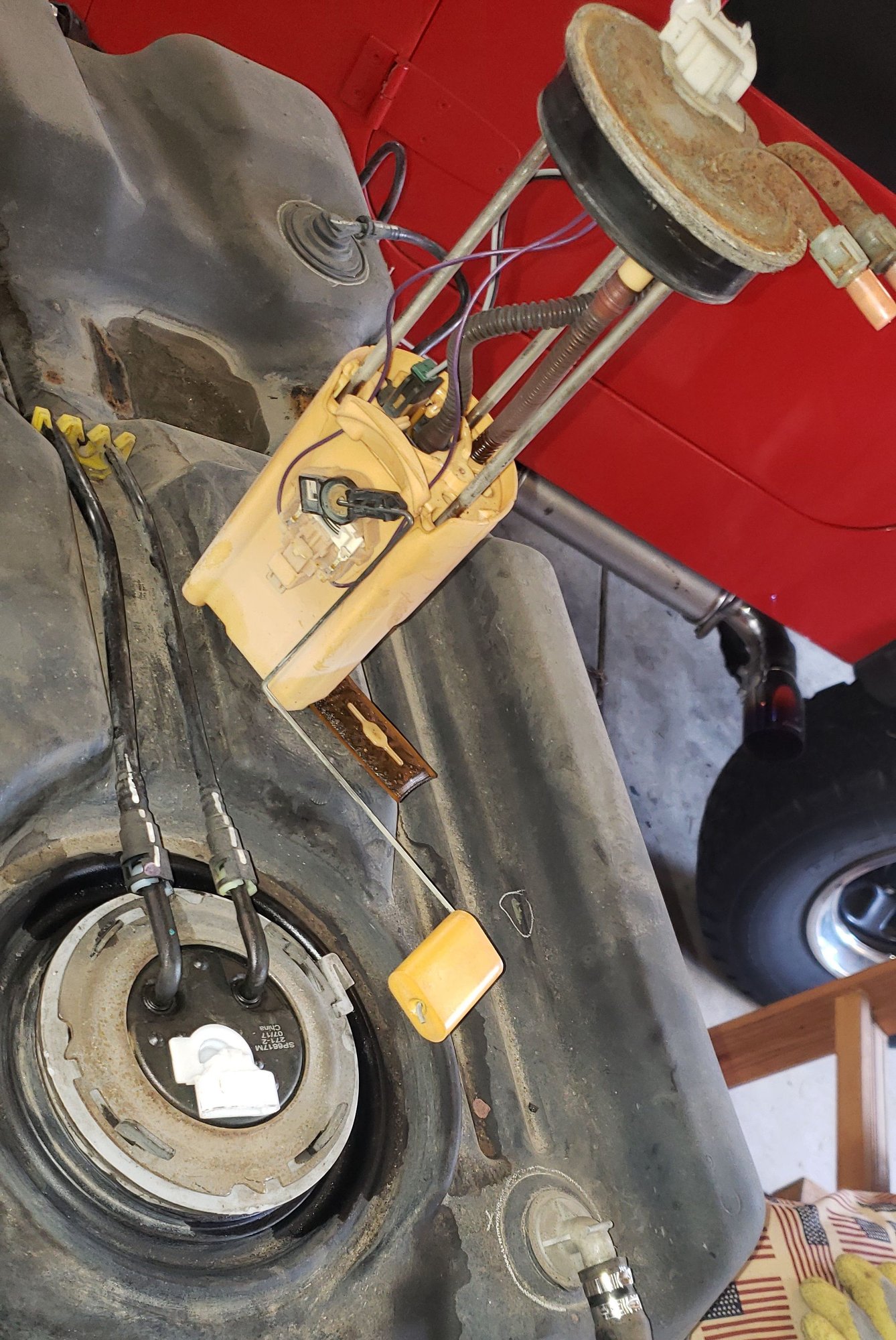

So one of my final checks and going over my new to me H2, was checking the fuel pressure. Key on engine off, 50 psi. Engine running, 50 psi at idle. Replaced fuel pressure regulator on the fuel rail. Still 50 psi. Drop the tank, actually surprised how uneventful that was. Top of old sending unit/ fuel pump assembly covered in surface rust. Swapped it out with a Delphi unit from RockAuto. And as I have a 2003 model, replace the fuel filter in front of the tank. Inspected all fuel lines, no Kinks. And fuel pressure is still 50 psi. My understanding is it should be 55 to 60 PSI. Am I perhaps incorrect In that? I checked the pressure with the different gauge as well and came up with the exact same result. Runs just fine. A little bit perplexed.

Default Old pump
That filter at the bottom of the pump has sure seen better days
