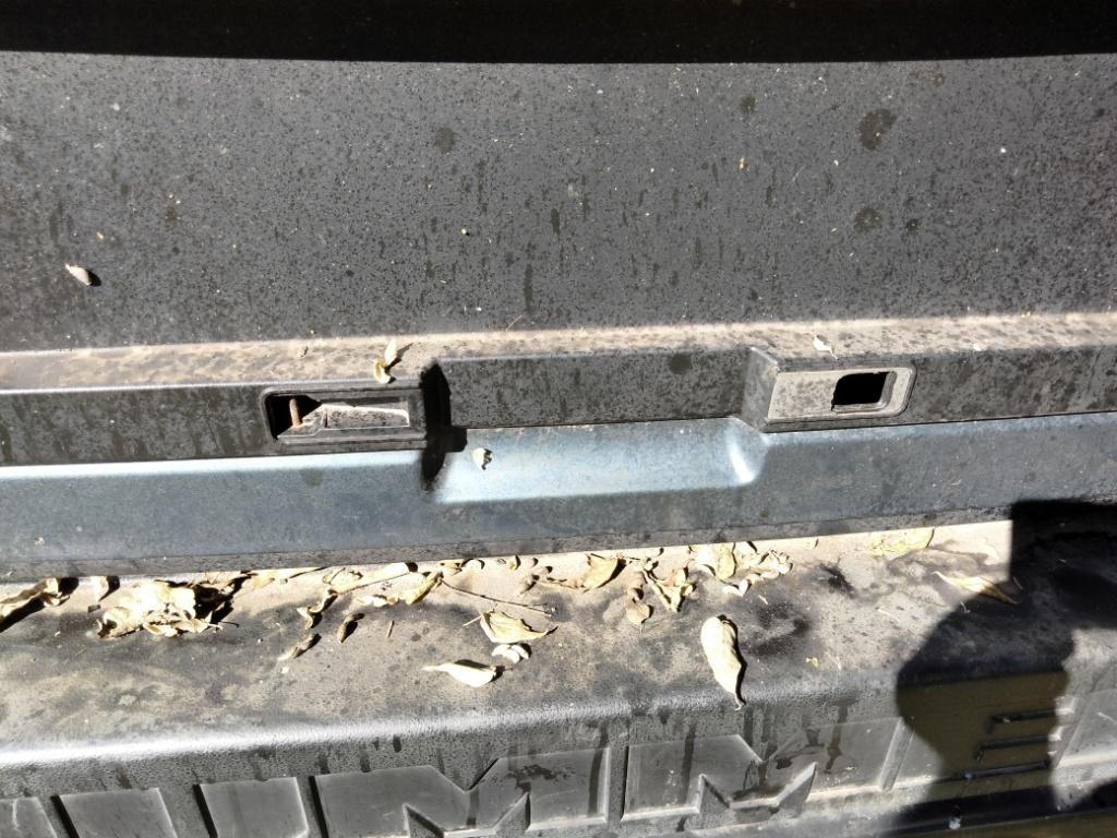

The rear hatch handle is broken. Is the only way to open hatch from inside ? I forsee myself tearing up the cheap GM plastic gaining acess to the linkage.

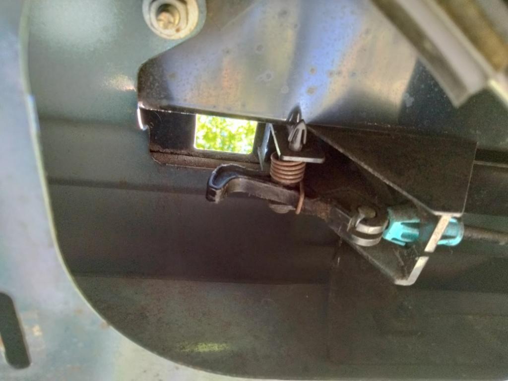

while cleaning the inside of H2 I found a small metal piece. I peaked though the right side of handles hole an observed a hook looking piece it's part of the linkage. it's kindof obvious what this peice is I found the other day. yet to test it w/ hatch closed but it doe's hook an moves the linkage. so the hatch handle has lower priority. still need driver side door handles.

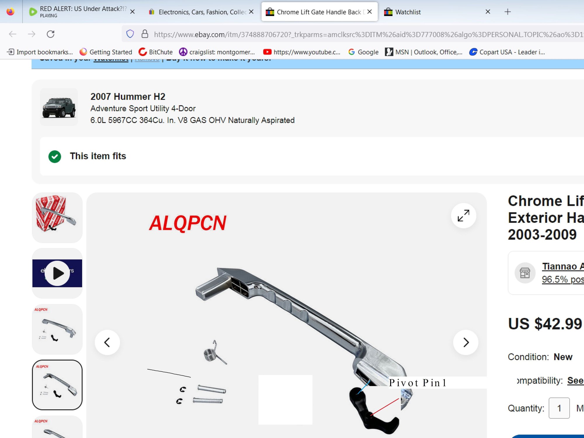

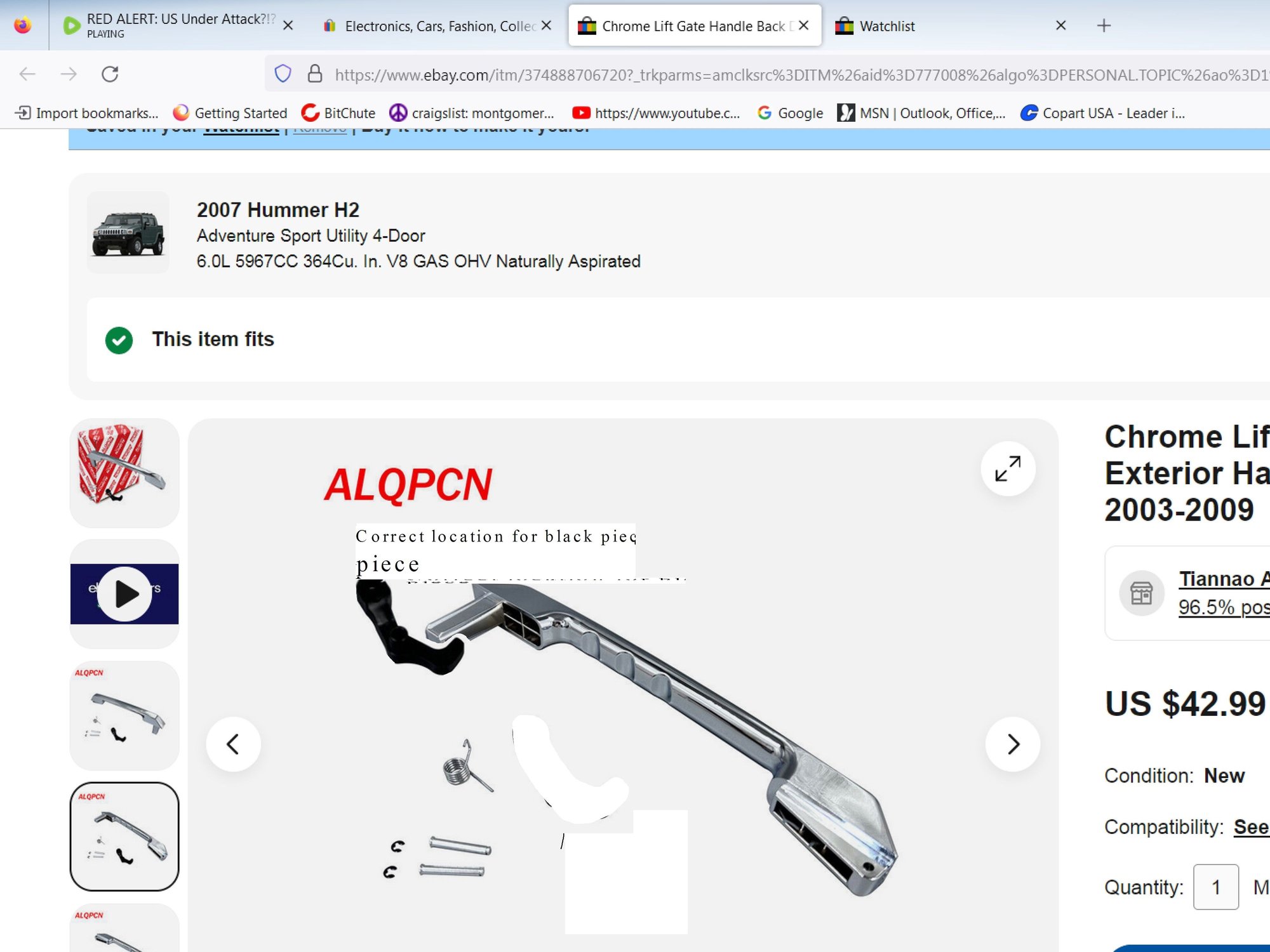

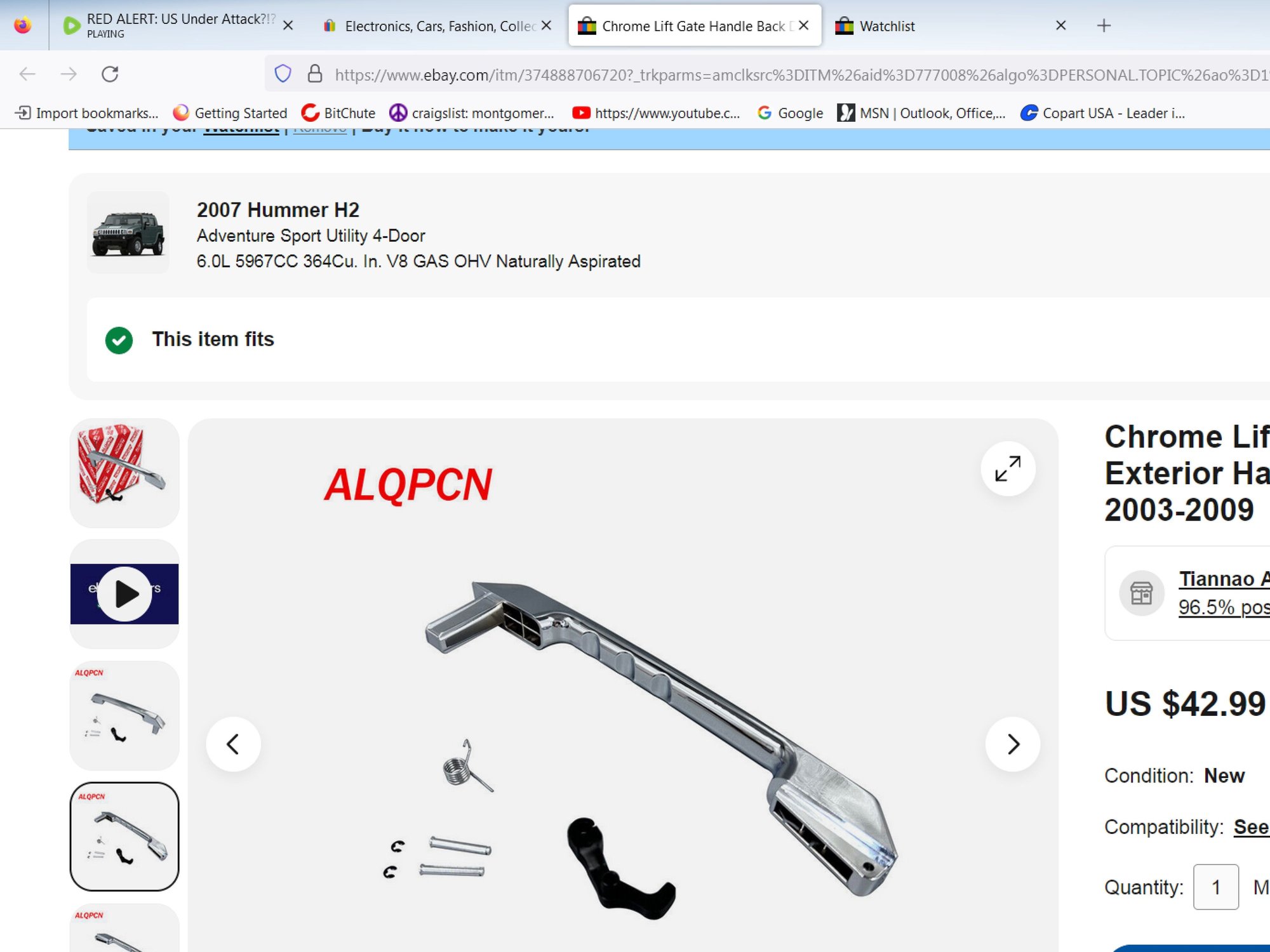

I believe the pin1 inserts into the black piece. the black piece & spring is still attached so it mit be easier to reuse black piece.
not sure but think the handle pivots where it attachs to black piece.
not sure but think pin2 holds middle of black piece?
I have a feeling there won't be any instructions. I bet the other end isn't attached to anything ? thanks for any tips.

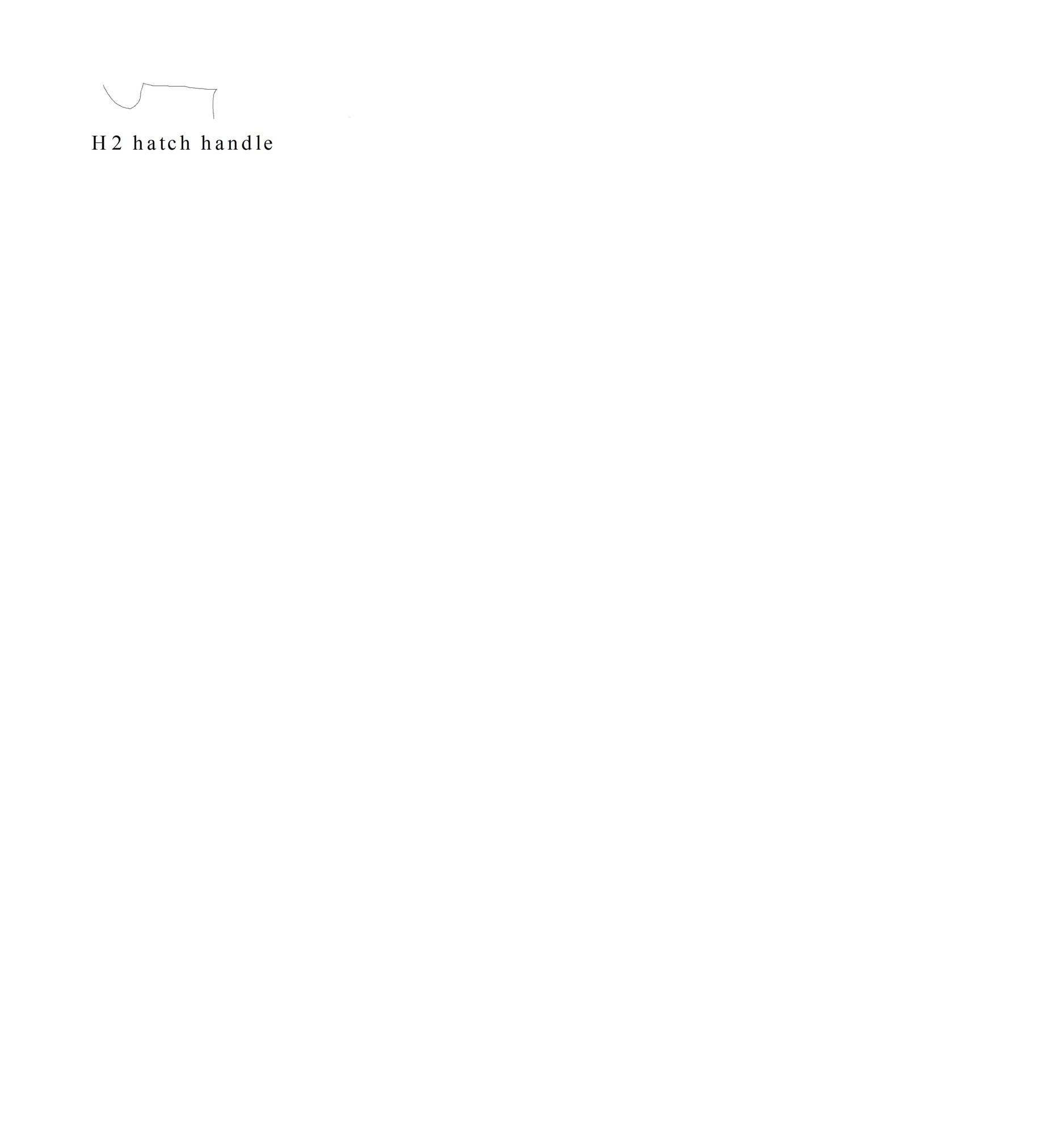

outside/inside image of handle anyone have inside image w/ handle attached. thanks

I dont have a pick but its obvious that hooked lever pulls the cable to release the latch.

think I just figured out how handle is attached.
looking at the images pin#1 attaches to the left side of handle this is the pivot point.
w/ license plate holder still attached will I be able to remove the pin#1 c-clip I assume w/ needle nose pliers? or will this whole thing need removing?
previous thoughts are incorrect, the correct orientation of handle is right end attaches to the hooked black piece which I plan to leave attached.
so my plan is to remove pin#1 (left end of handle)
insert right end of handle into square hole and attach black pieces hook to handle.
then position left end
then insert pin#1 though handle.
pin#2 attaches black piece. thanks
