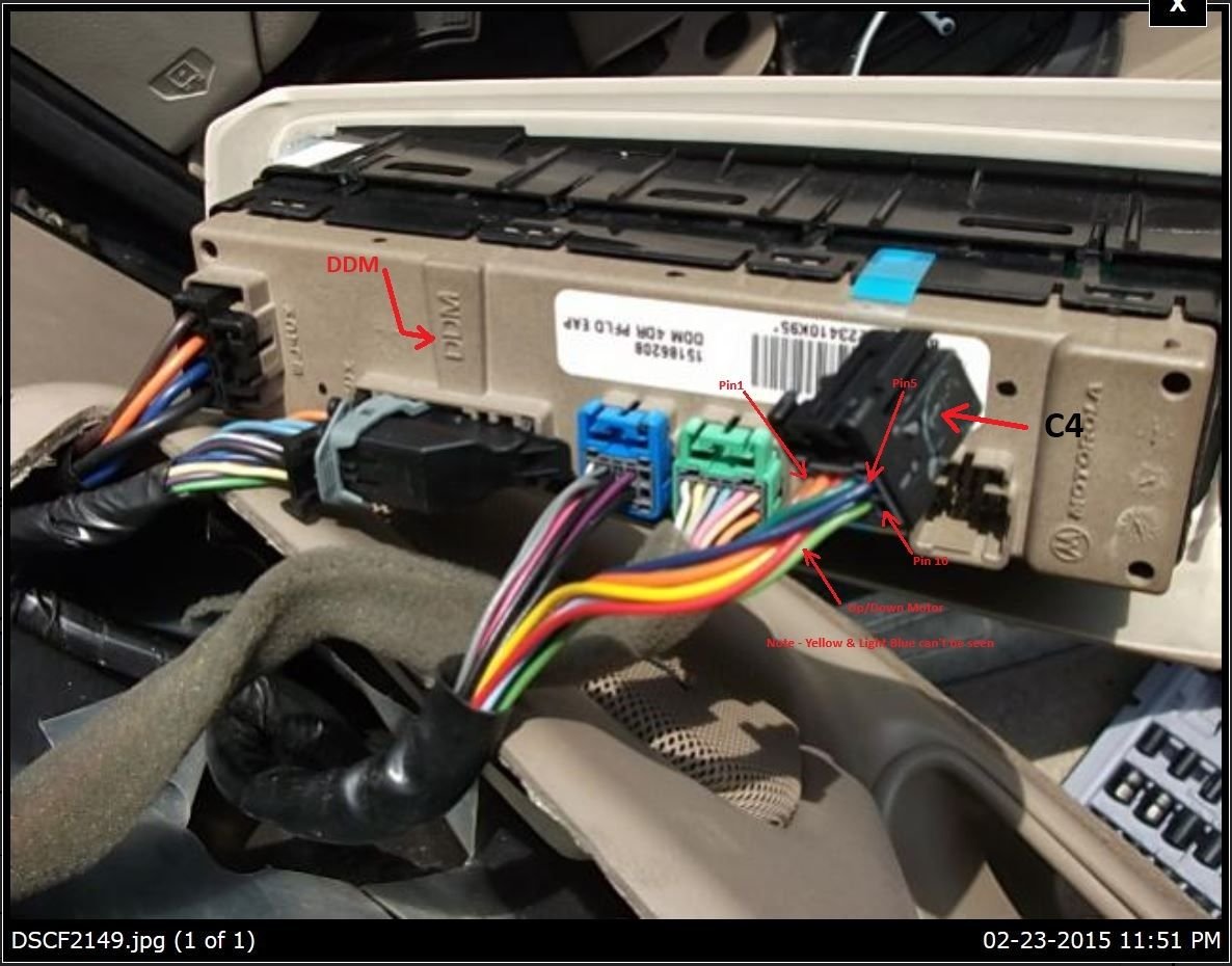

Motor Tests
This quick and easy test will tell you if the motors are wired correctly, pull-out C4 the 10-way BLACK connector and measure the motor resistances as follows:-
i, Between C4 Pin-7 Yellow wire and C4 Pin-8 Light Blue wire, this should read as 4 above (left-right motor movement)
ii, Between C4 Pin-7 Yellow wire and C4 Pin-9 Light Green wire, this should read as 4 above (up/down motor movement)
If either/both have the resistances as specified (but not short-circuit) they should be turning, you may have to press your ear against the mirror casing as they are fairly quiet.
If there's no resistances its likely and issue with the wiring, remove the mirror-glass (easily done) and inspect the wiring to the mechanism inside, the motor gears as well.

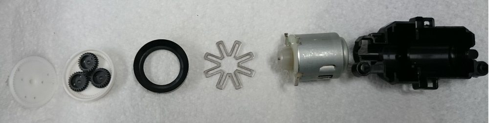

fyi this is what a motor looks like, for scale its 1" in diameter and about 1.25" long
This is what a disassembled gear assembly looks like
This is what a broken gear looks like
