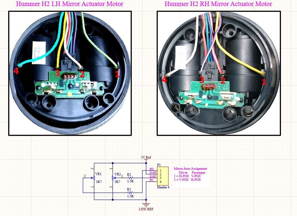

The 07 DDM is possible similar to an 05 with the All Up/Down window control buttons in the door panel.
The diagram below shows the DDM PCB circuit that controls the motors, as Extend/Retract works IC1 is probably OK suggesting either the mirror motor mechs are defective or there's a problem with the wiring.
3 possible approaches:-
  1. Listen closely to the outside mirror, if you can hear the motors spinning it suggests the gearing is broken - very, very common.
  2. Prove the DDM is OK by popping it out and putting a multimeter across either C4-7 and C4-8 (Left/Right) or C4-7 and C4-9 (Up/Down) you should read +12V whenever the mirror-switch is operated, note polarity changes with direction.
  3. Swap over the left door/ right door mirror motor assemblies (they're identical) it's quite easy and quick to do
The 07 mirror motor assemblies may have a single PCB connector, however the 05's have individual motor wires and it's easy to get them crossed.
Hope this helps 🫰

It folds fine. No noise or movement at all for mirror. Need to at least measure across left right switch. I read that if I’m not reprogramming
I need to at least make sure master switch is from a h2 not Chevy truck or the all up/down won’t work. I’ll do some measurements and at least try a new switch assy. Thanks

The Driver Door Module (DDM) is a sophisticated micro-computer which communicates via the BCM to other modules, for example the PDM with its own power-mirror, door lock, windows etc
Performing complex functions the old way would require a lot more harness, relays and fuses etc, there are so many hidden features in the DDM, for example if a power window is obstructed it will automatically reverse, there is also the express-down function and individual window control, all hard to do without a CPU.
Testing the switches is practically impossible since they form part of complex membrane pad assembly, here's a video showing the DDM construction and how to clean the membrane PCB if you suspect the mirror selector switch isn't working.
Have to say damp and condensation are the No1 problem with these modules, rain soaks in when the doors are left open, once to wet gets in oxidization and corrosion occurs which can rot PCB tracks and the button contacts.
Sticking with the original module would mean one less variable to deal with until you've established the mirror motors are functioning.
You can unplug connector C4 and measure the 2 motor resistances, or as mentioned see if 12V is present across them when you operate the 4-way switch.
You're correct about DDM, there's at least 2 versions, they look the same but earlier modules didn't support the "Global Windows" function as it wasn't required, think that's 03 and 04, also I think the later modules are backwards compatible.
I bought one and no programming was required, available on Amazon and eBay, very cheap.
