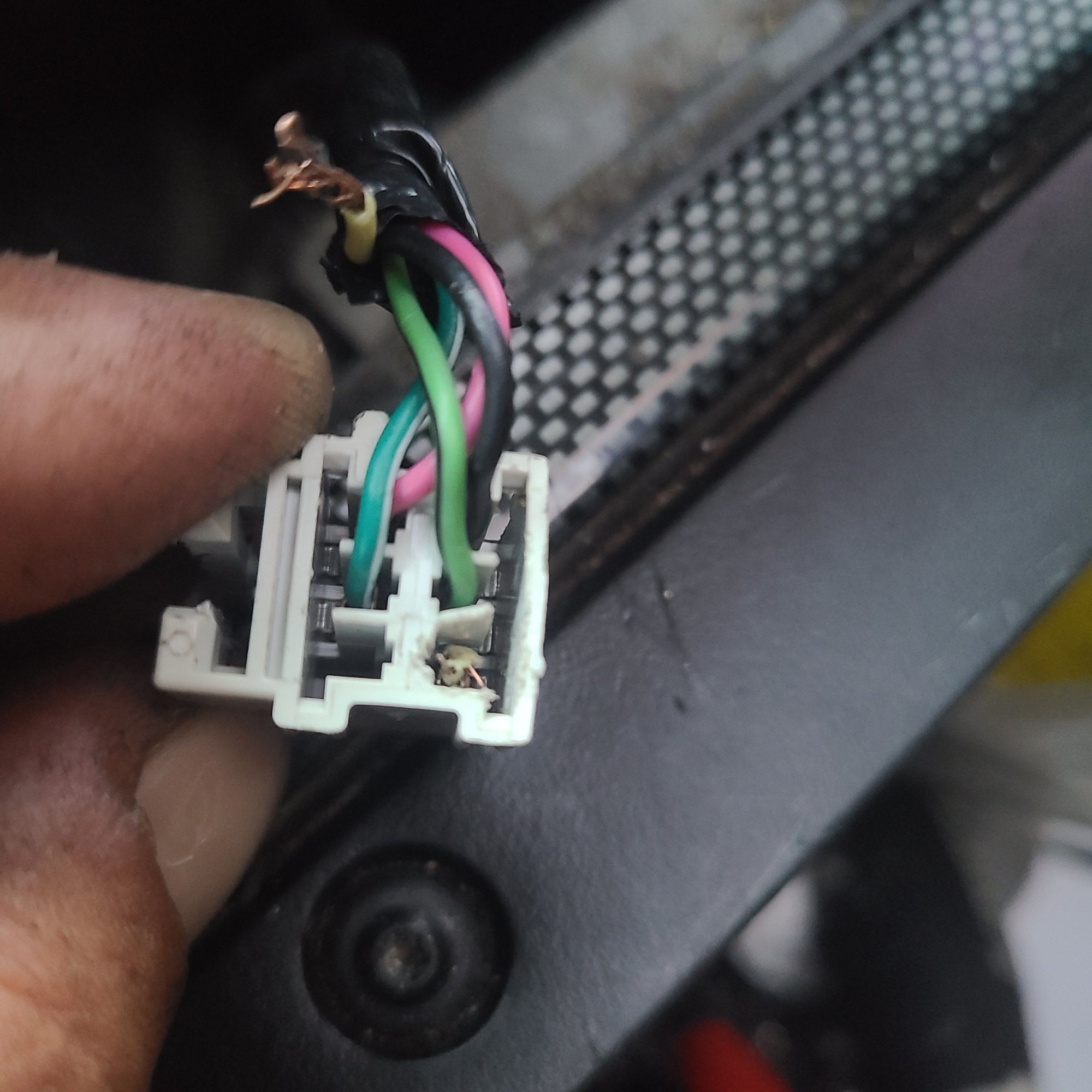

I have an 2003 h2 hummer and key wont turn or shift out of park I removed shifter console and was a broken yellow wire i spliced the remaining yellow wire and tried to put in back on connector by shifter and the ignition clicked a few times then nothing.i am at a loss on what to try next.remote start works but key doesn't turn on.as soon as I hit the brake shuts off.is the yellow wire on that connector that broke terminal c the key lock?what else can I do to try and get this fixed from home since it won't turn or shift.i pushed that button under shifter to put in neutral but still couldn't turn key at all.

i had the same issue on my 2003 i was able to pull the pin out of the connector and solder it back onto the harness then reinstall it into the connector.
the picture above is how i had found mine. the end of the cable had pulled out. i depinned it, the pin connector and soldered it back. i had to unravel the tape so that the yellow wire in the loom got a bit more slack out of it.

maybe this will work. i am not shure the colors are in the correct order but you may be able to depin it

same thing happened to my 2008, replaced the plug and its been good for years now.

Just replace the entire cable/connector assembly (see the link above) this is a common problem and it will just break again if you piece part it and try to fix the original connector/wiring.
