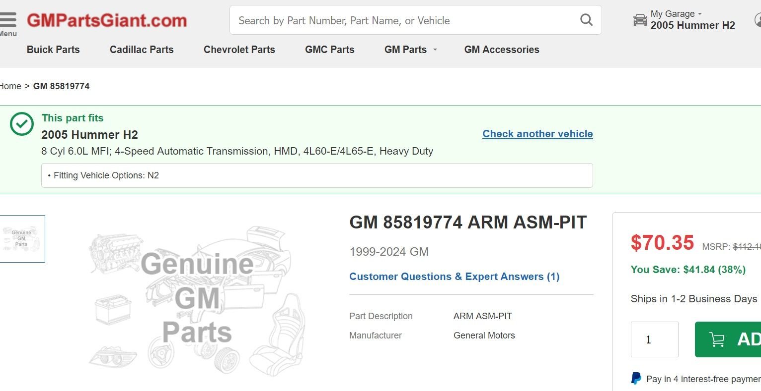

I have to replace my pitman arm on my 2005 h2. Does anyone know if it is a 3 spline or 4 spline, or is there anyway for me to know without having to take off the part?

Go to the GMPartsGiant web site HummerZ posted prior and enter your VIN, It will provide you with the correct pitman arm part and tell you if its a 3 or 4 spline part.

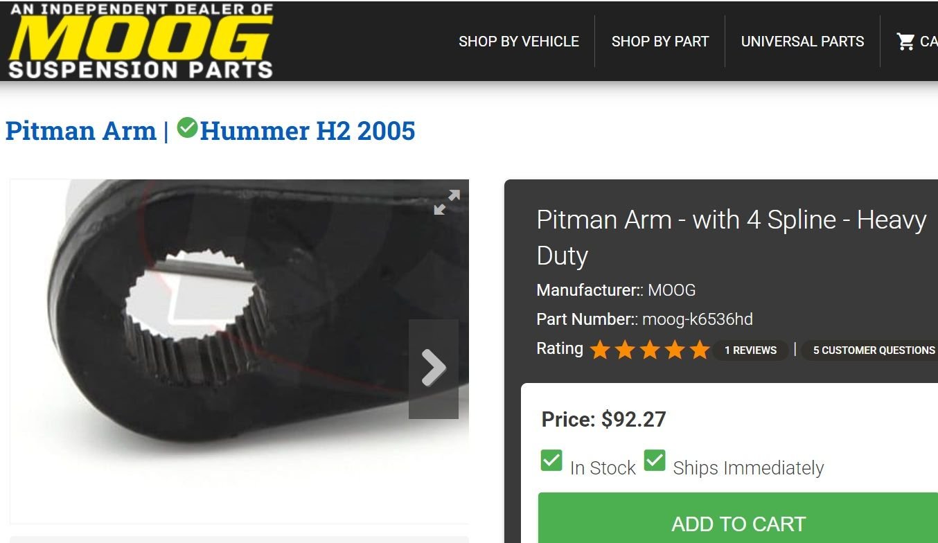

I don't know what specific "N2" code that is mentioned as all of the RPO codes are 3 letters. I will say this, I have replaced the pitman arm on an 05,06 H2 and have purchased a spare for my 08 and all were 3 spline arms. For what its worth the only place I have ever seen the 4 spline part was on a 3500 series GM truck.
If you want the 3 spline HD version of the Moog part order: MOOG-K6654HD, these are the one's I have always used and are every bit as good if not better then the original factory GM part, and work great.
