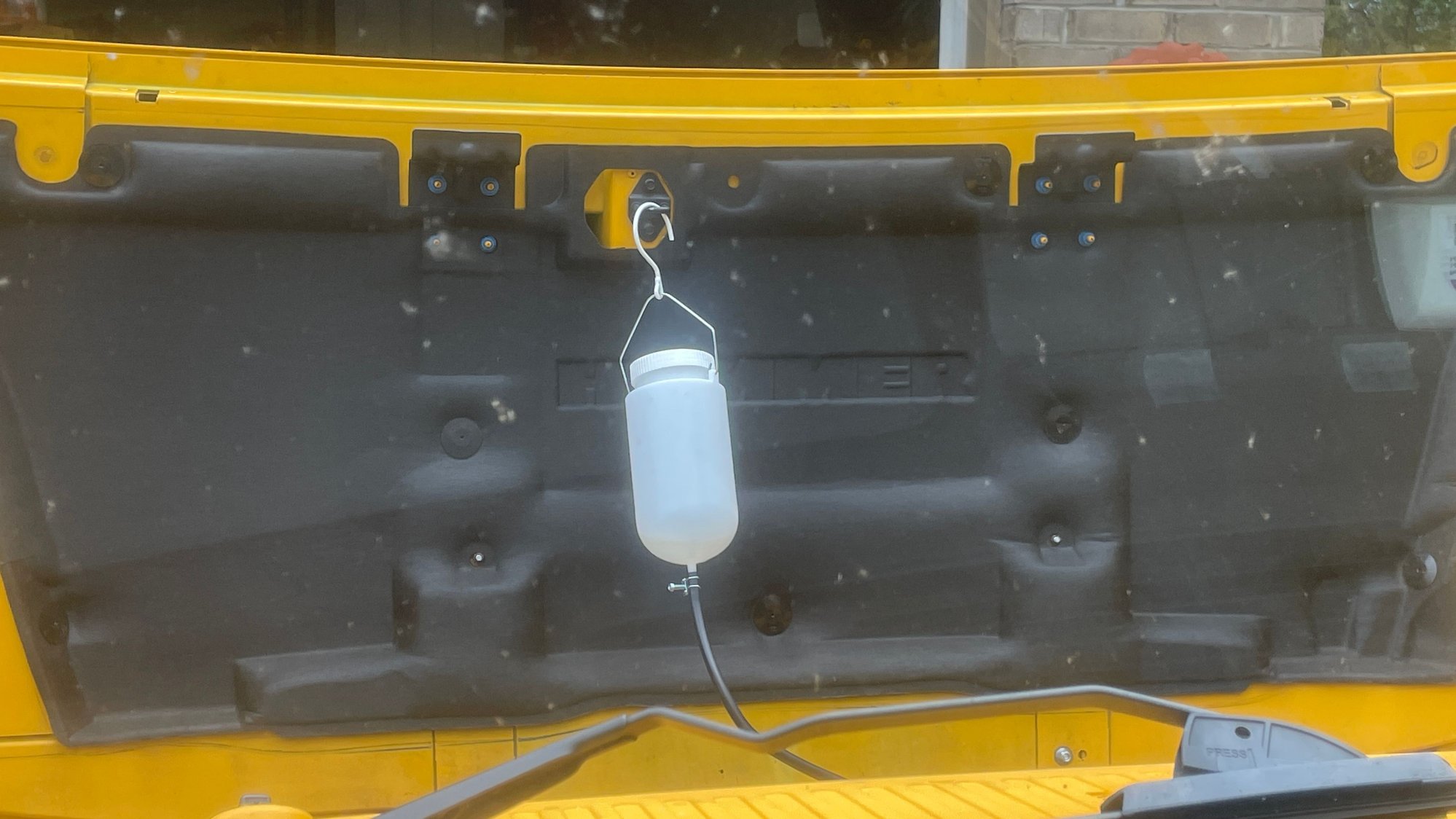

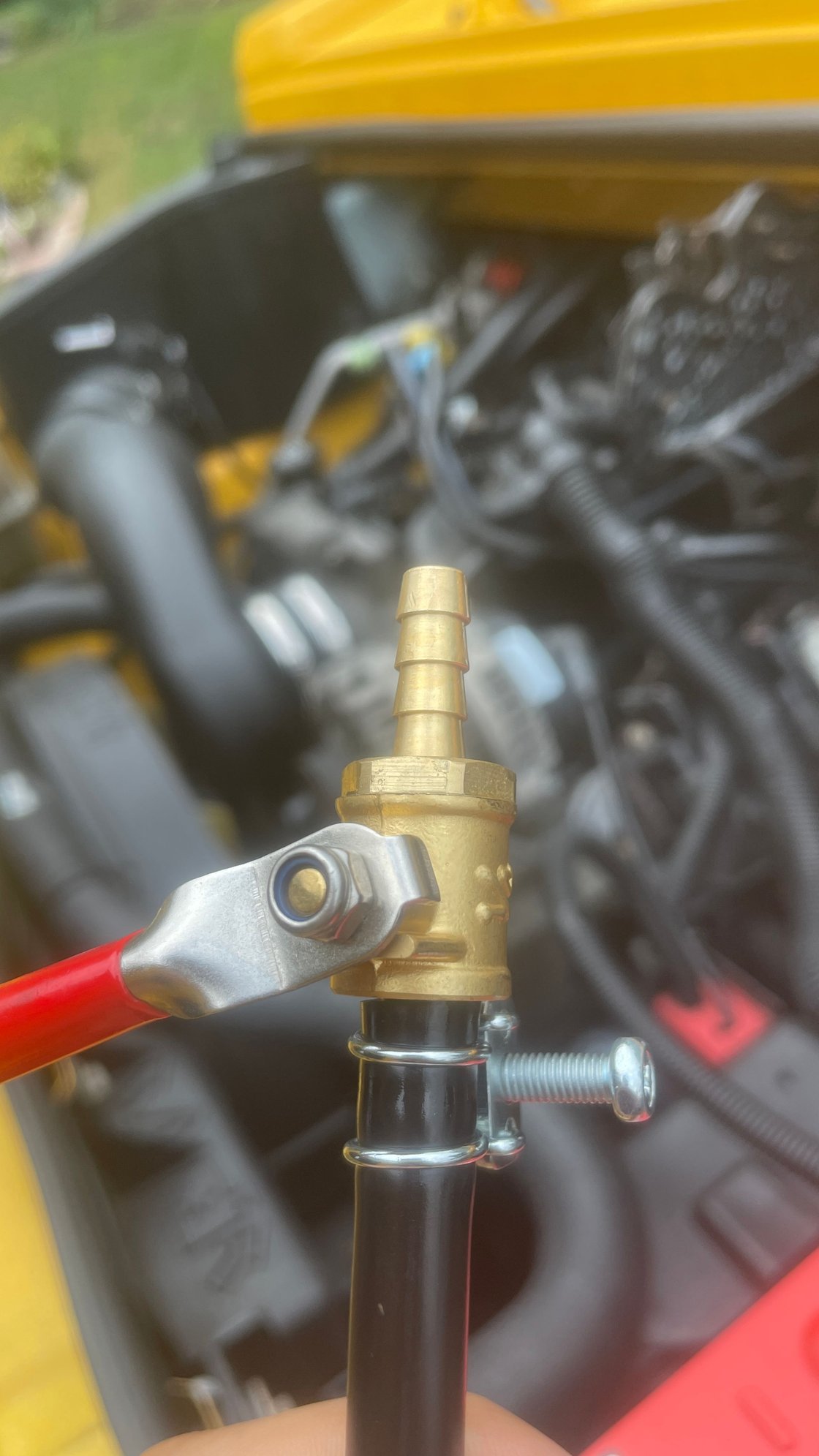

I use a fuel induction drip applicator with a valve to control to a slow drip. DIY, Start up and use any object for a pedal depressor between the seat and accelerator pedal to maintain 1000rpm over idle. Then walk away and check back in a half hour or so. When empty, shut engine off, disconnect and let hot soak 10 minutes, then drive it like you stole it.

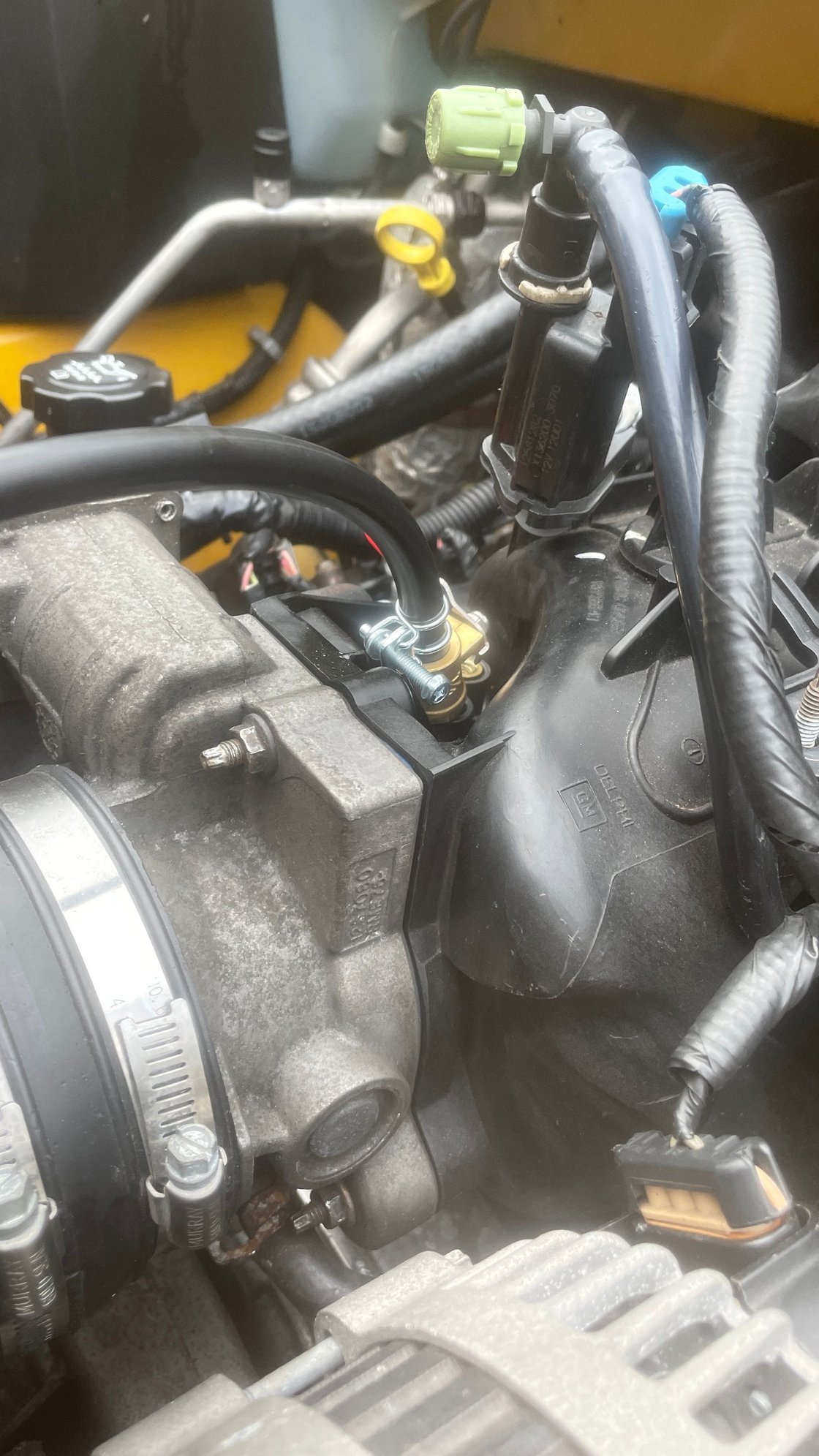

Update, First treatment I out 8 ounces into the drip can. Went for a drive after 50 minutes like I stole it haha, The acceleration was smoother and the engine much quieter at low rpm and even at 75 mph. Its designed for motorxycles but works perfectly in the evap valve above the trottle body. I did a second treatment of 12 onces. Letting it sit overnight. Will give you update 2mrw. Here is the drip I used on amazon.

Update, ran 12 oz through on sencond time. Let it sit overnight. Was a little bit of smoke nothing crazy. I have cleaned it before with seafoam and have been running liqui moli valve clean over last few months. Next h2 i get ill run 16 oz first time. It did run even better smoothest acceleration so far. Cheers
