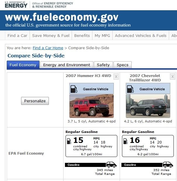

Old Apr 28, 2023 | 06:26 PM
Posts: 9,017
Thanks to all the TREE HUGGERS there are>> landmark fuel economy standards The Chevy TB had a lower curb weight, with the LL8 installed, kept the mpg at/above standard at the time.
