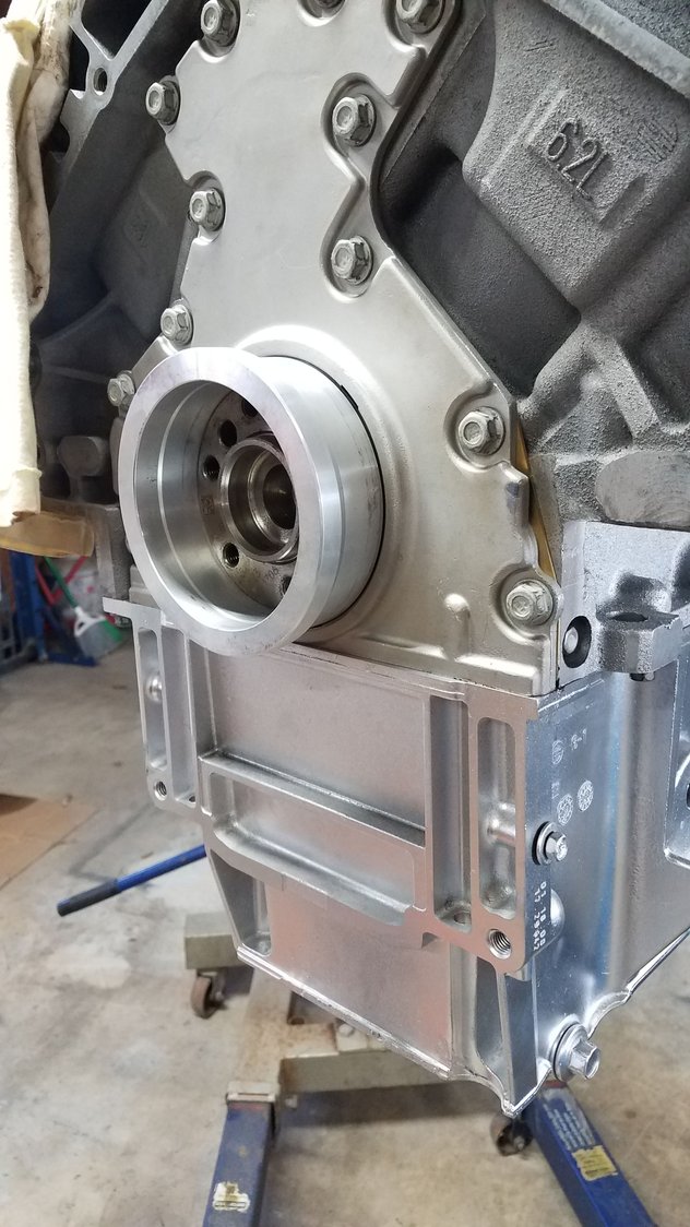

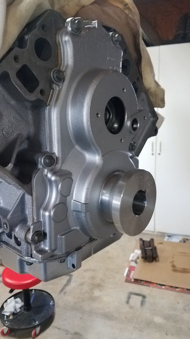

front cover mounted with centering puck installed
rear cover centered and torqued
should finish the oil pan tonight hopefully, need some sealer first
Oil pan was temp installed to align the front and rear covers with the rail
Neal

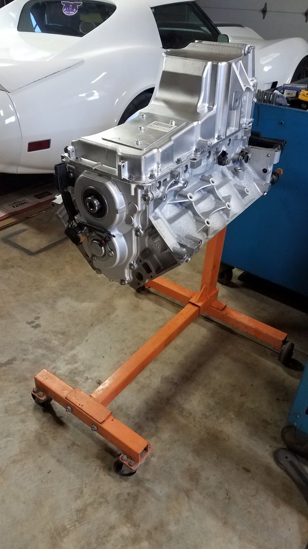

Oil pan installed along with VVT actuator, Cam position sensor and harness mounted
Neal

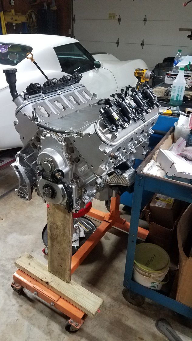

Heads torqued, valve covers cleaned and installed, coil packs cleaned and mounted, coolant air bleed pipe temp installed, lost a bolt so headed to dealership in morning, motor mounts cleaned painted and mounted. Things on hold, ended up with 16 exhaust rocker arms, contacted company that I got them from and they have shipped 8 intake arms to me.
picked up a fitting for the front oil galley to make a oil primer setup. I made one but I had to hold the tubing by hand, now I can screw it in and let it prime.
Neal
Almost ready to drop in

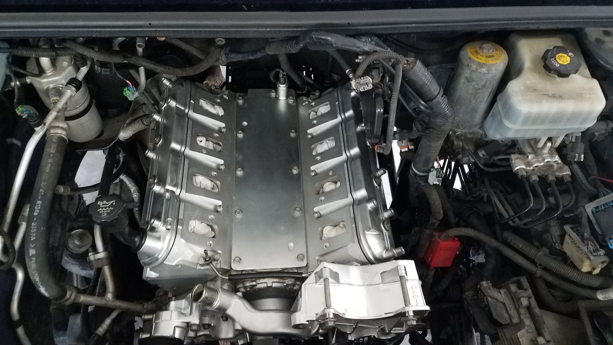

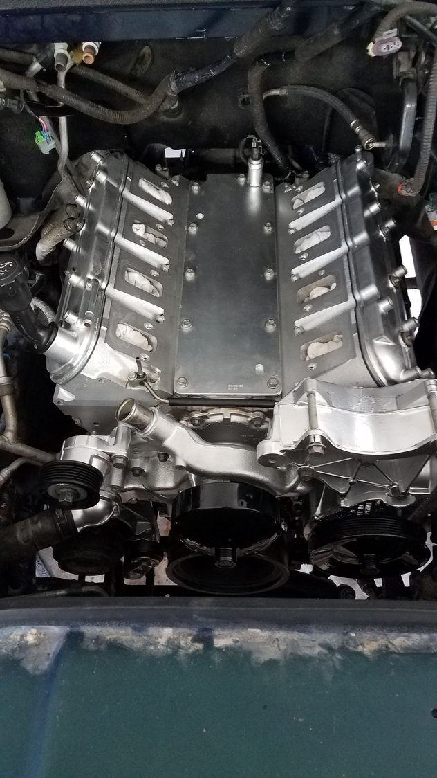

well its in, now to get everything bolted up
man, that balancer bolt is a bear
