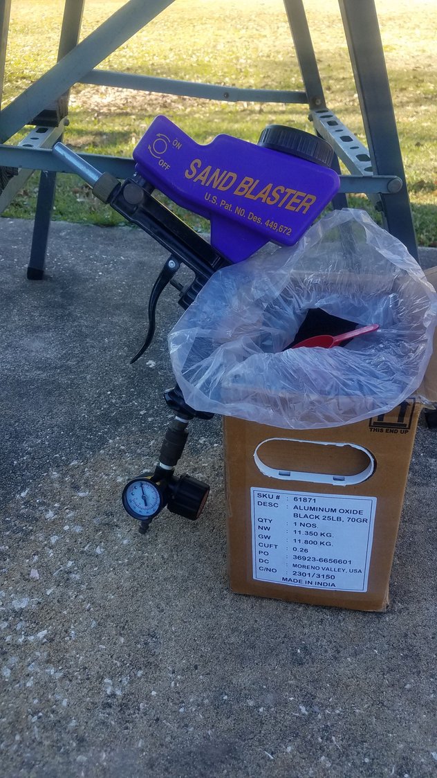

Started prepping pistons;
Hand held blaster with Aluminum Oxide for the surface prep.
Some of the pistons cleaned, baked to off gas and ring lands tapped off ready for blasting.
The lower piston blasted and the top piston just prior, for comparison.
