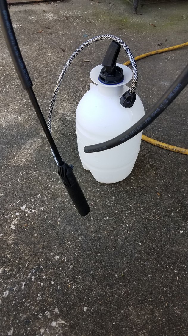

home made LS engine primer, pump up sprayer bottle with gallon graduates. Cut the spray tip off and pushed a section of fuel line on it. need the trigger still for on/off encase something unexpected happens.
I made this fitting from an O2 bung plug and a hose barb. push the hose from the sprayer on it and start pumping.
I forced 5 QT's of oil in the engine while turning the engine a 1/4 turn every 5 minutes or so
The fitting is in the main oil galley right at the oil pump discharge, this needs to be done to prime the oil pump and get oil through the engine prior to start up.
All that's left to do is tighten the spark plugs and install the plug wires then we'll see if it will crank.
Neal

Never seen that before, yet you got the idea. Just make sure the oil filter is full too before startup. Also make sure to change oil&filter after break in. Nice work.

It cranked right up with good oil pressure and no odd sounds or leaks so all is good,
