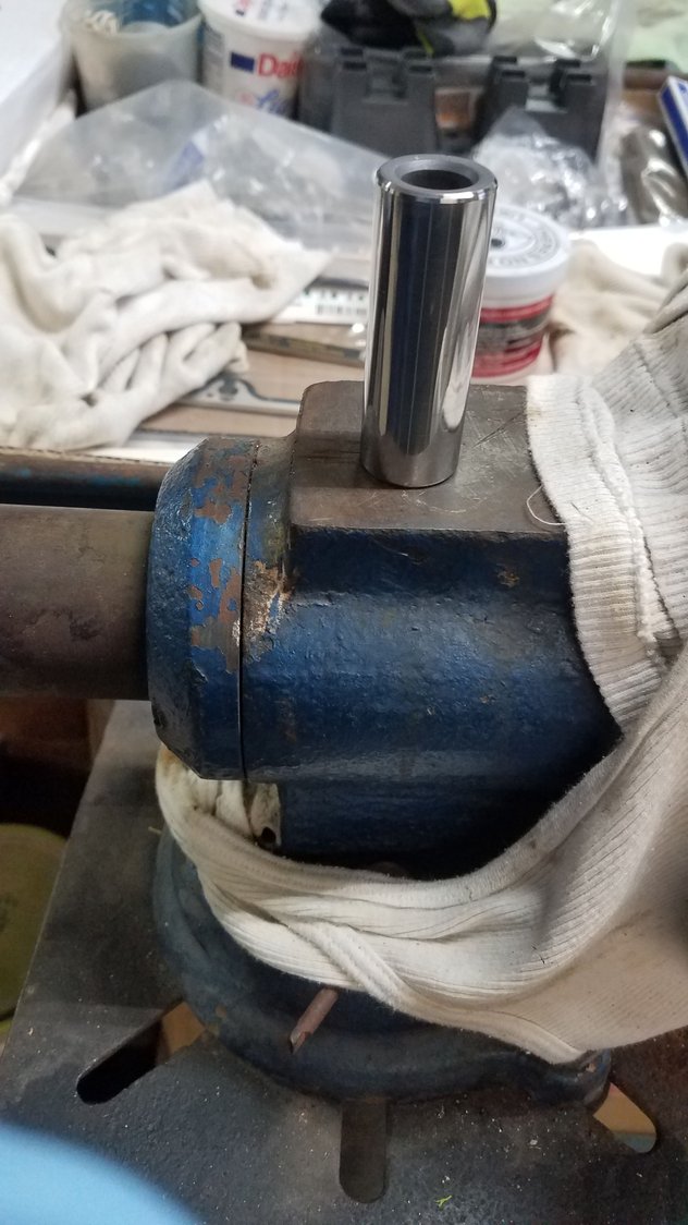

Pistons in oven curing
Polishing piston pins

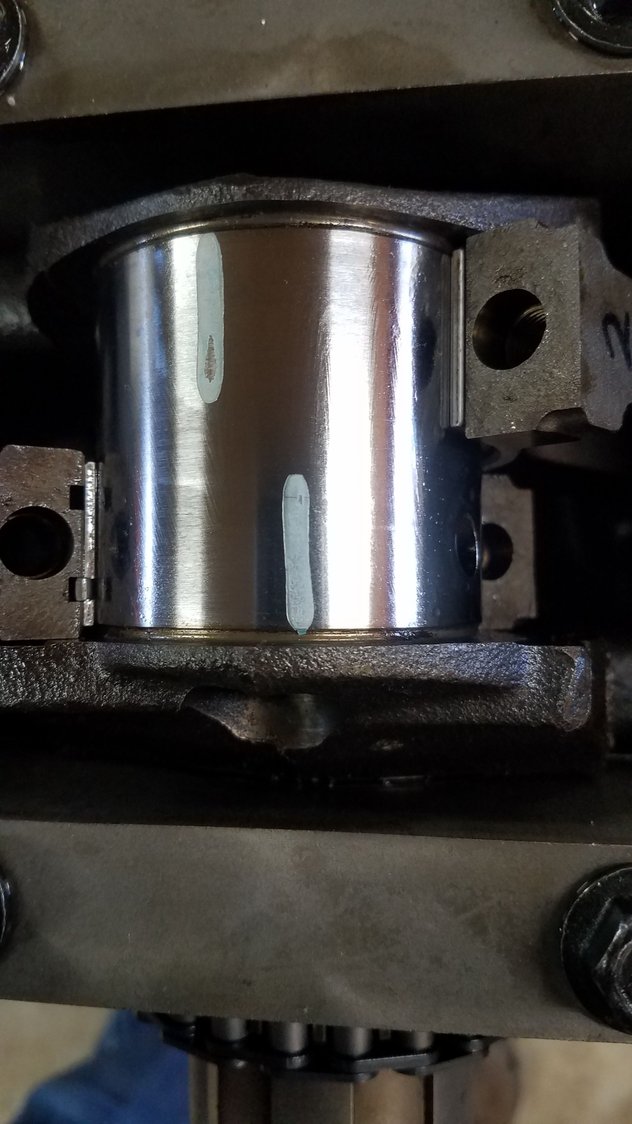

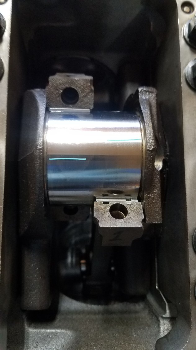

Plasti-gauge ready for cap install

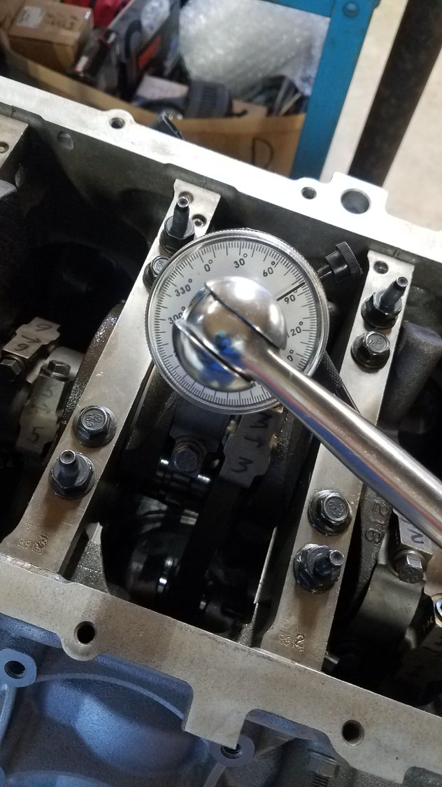

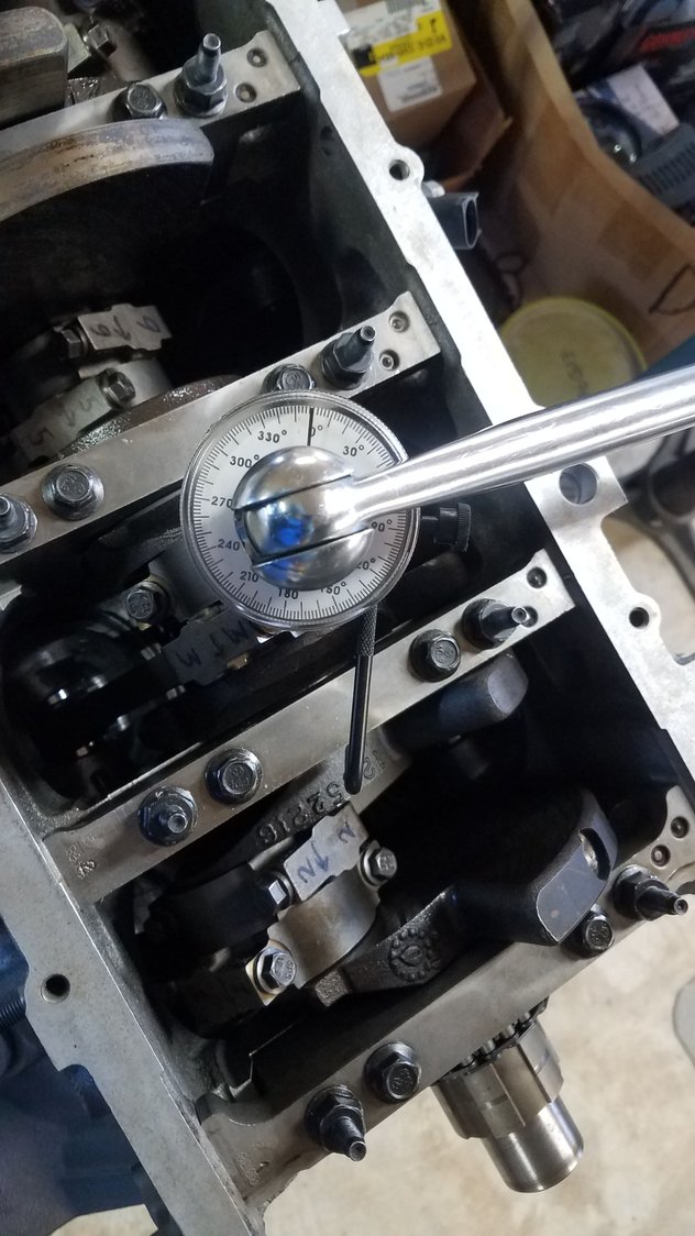

Degree gauge set and ready for 85*
Rod bolt rotated to 85*
Caps removed and clearance checked, .0016" well within spec.
Everything checked good and the caps are all TTY, moving to getting oil pump installed and front and rear covers set.
Neal
Old Jan 20, 2020 | 07:53 AM
  #45
Plastic visibly looks right on to me. Nice work. Keep some good assembly lube on everything and keep getting it all back together! I'm sure you are since you are this in depth but make sure to use the proper tightening sequences and torque specs. So easy to miss inch lbs vs ft lbs or nm... Wish docs were always a bit more consistent about those things but easy enough to calculate one into the other with all the online calculators. If you need any from the GM eSi system docs post up and I'll pull the page and upload it.
