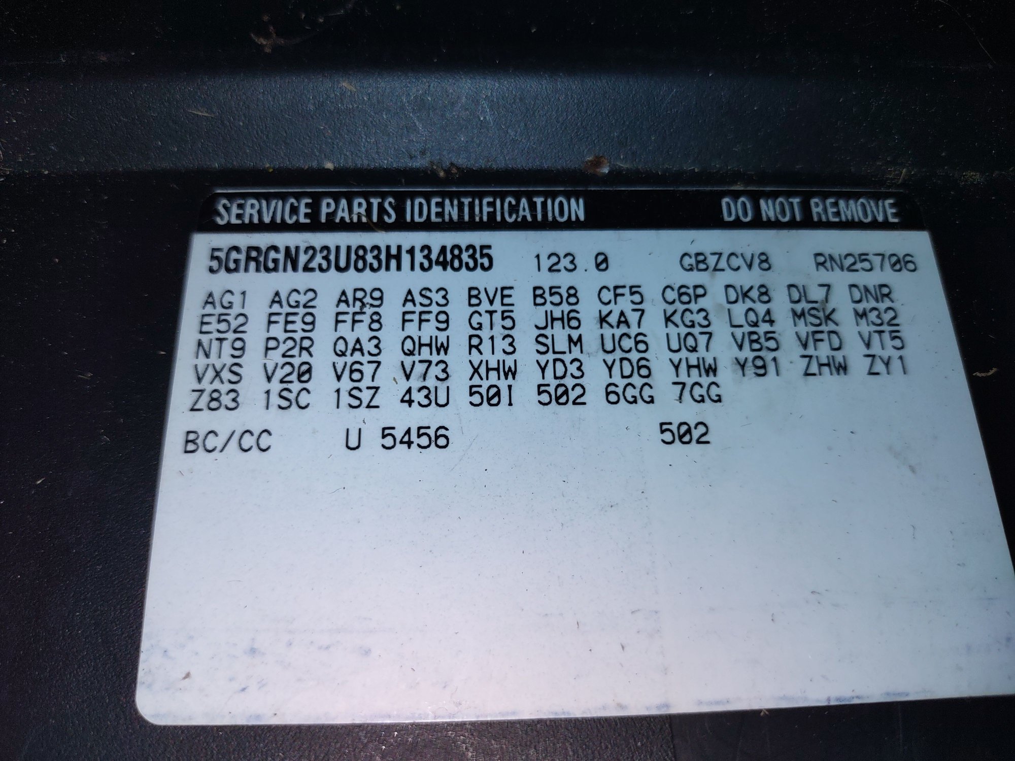

Correct information on the forum is quite important. Relying on a Google search with AI is not usually accurate. The 4l60 have an RPO code of m30, the 4l65 has an RPO code of m32. Two different animals.
A lot of what's on the internet regarding this is wrong. So what follows is a picture of an early 2003 Hummer H2 label with the RPO codes....
As a general rule on these forums, if you don't know what you're talking about say so.... Like if you're taking a guess at it.

From: Mojave Desert
No I agree, my point is I fail to delineate between submodels of the 4l6xxxx transmissions. I believe there's a 4l70 or something as well before you take the training wheels off and graduate to something you wont have to spend $1500 rebuilding every year like its clutch maintenance...
ah yes a whole 20ft/lb of torque rating difference in the two transmissions.
