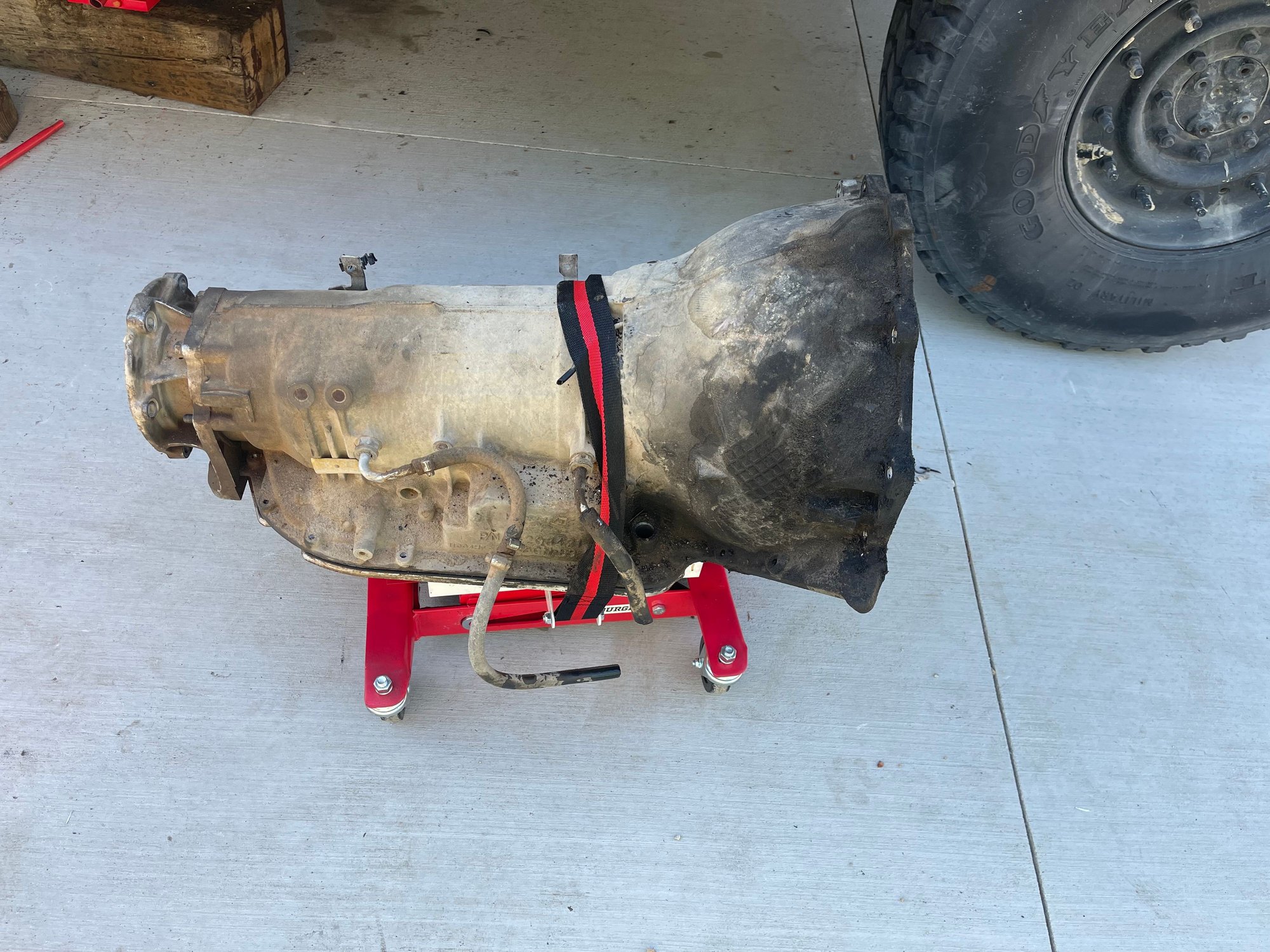

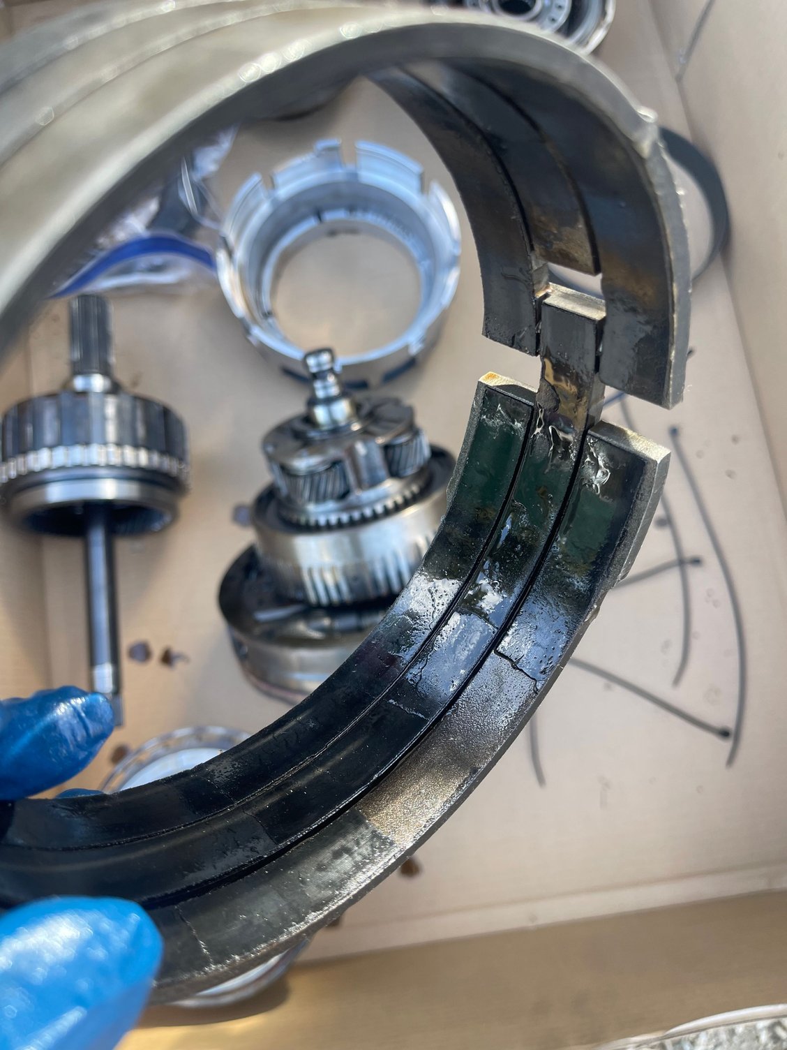

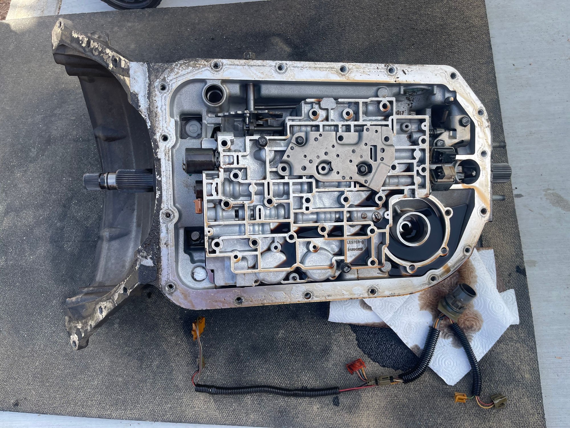

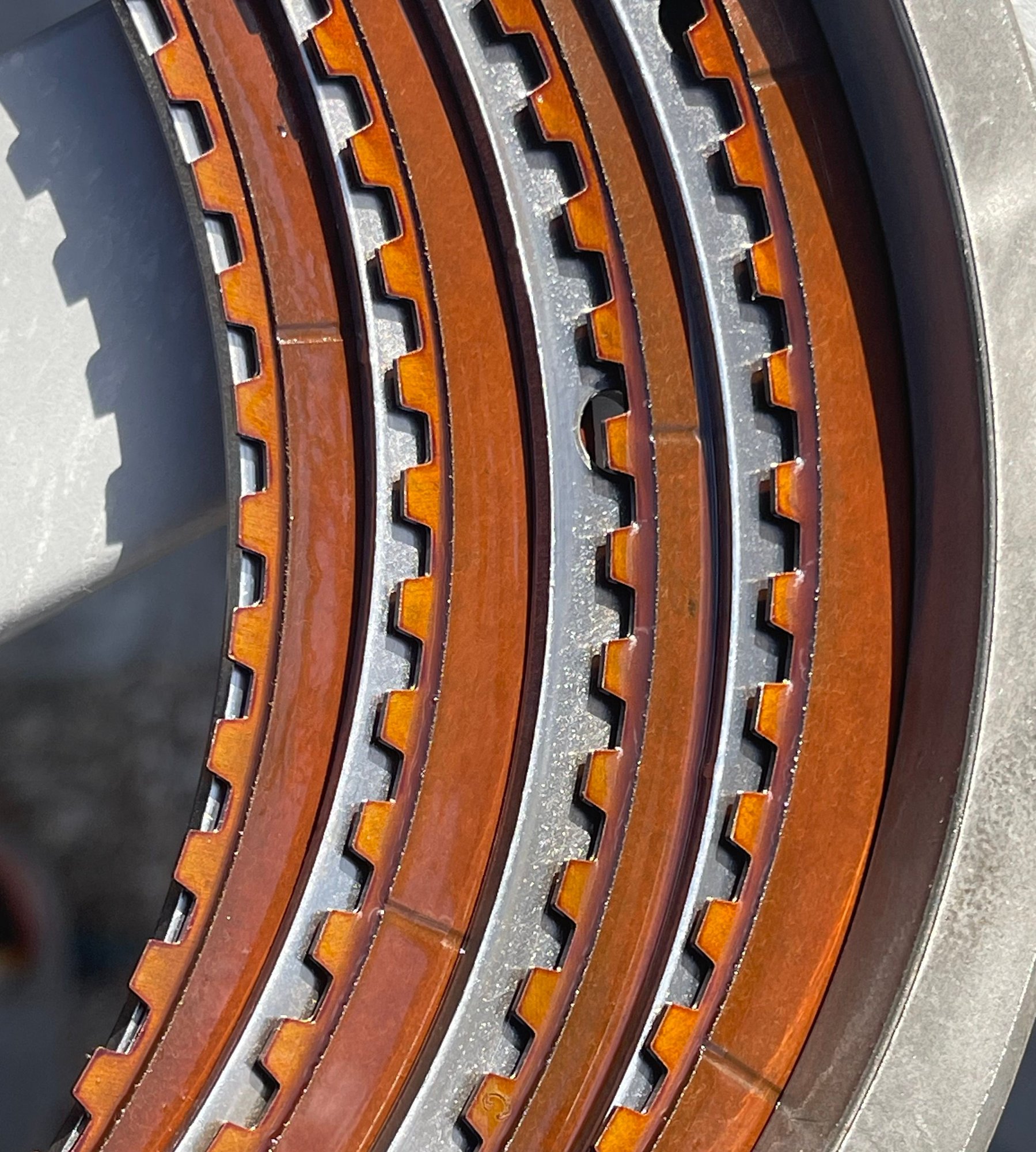

I have personally rebuilt 4l80e
its one of the best transmissions created,
but swapping into the H2 is not the right choice for multiple reasons,
then you open a can of worms,
different size drive shafts,
different transfer case,
different splines,
different shift linkage,
different bell housing
different shift ratios
different different different
should I go on ?
I can easily upgrade rebuild 4L65 to be as strong or even stronger than STOCK 4L80e

I know my 4L80e , I have rebuilt that myself, easy and amazing unit but not a Transmission right for H2
