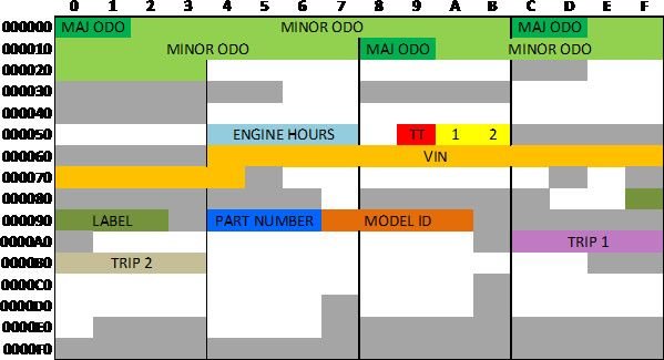

Sorry 256x8 Bit EEPROM so only 256 bytes of memory, so not big.

Might be similar to this:-

the milage is not encrypted and human readable. i do not recall what offset the data is located at. but i am sure you can query the data dump.

on 03 and some 04 it lives there on the right side of the PRND321 screen and above the odometer
on 05 it changes location a bit away from the 2 screens if i recall nearer to the fuel oil / gauges

here you can see some of the human readable data
https://youtu.be/oC9Q78afbPQ
I found several videos from a Youtuber named Jack Myers. He shows the complete process of removing and adding a new eeprom on the cluster along with programming it

Coming back to the odometer, having now seen the work out there, no doubt one could to write a utility (Python maybe) to read/set the mileage plus any other parameters, there must be people who do this.......
I can see it may pose a legal question after upgrading unless zero miles was the new staring point, not sure if physically transferring the original EEPROM would get around this, it's not really my area.
