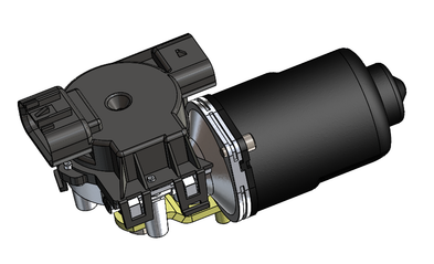

TBH never really considered, or got into, the odometer topic for various reasons, however I did consider reverse engineering the IPC mainly to address some of the many reliability issues people had with it. If I could get my hands on an old one I would, ditto for the BCM (scrap parts not easy to acquire in the UK)
There's so many items of interest in the Hummer, many involving electronics, mechanics and software, the latter being one I've yet to touch on. Pretty much deal with components as they are encountered, for example :-
Boring for many, but challenging nonetheless, it's all aimed at understanding the issues and helping folks keep their stuff going.
