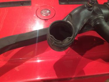

My 03' H2 started popping up a check engine light about 2 months ago so I had it immediately checked. It read Code P0174 (System too Lean Bank 2). This is normally due to a clogged air filter, cracked air intake, or bad Oxygen Sensor. So I removed the air filter (cleaned it) and did a QUICK check of the intake. It turned off. It only lasted a week, but turned off again a day later. For the next two months it would stay on longer and longer but always shut off. Today I read the CEL and it pulls up both Codes P0174 and P0171 (System too Lean Bank 1). I had bought the Oxygen Sensors and was getting ready to install them, but while popping the hood I noticed the intake pipe was a bit loose so I removed the entire intake and I found out that someone before me had incorrectly installed and left a folded piece of the pipe on the inside of the seal which caused a good air leak. (See Pic) I never noticed it the first time because I had never removed it The CEL shut off and has not come back on since.
I bought my Hummer used and the same thing was done to mine that rubber boot all folded up.
