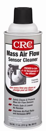

ORIGINAL: Crash
Mass air flow sensor in the intake tube is now covered in oil from the K&N.. Take the MAF out, wipe it down and see if clears it up.. If not, new MAF..
NEVER touch the MAF with anything, do not even think of wiping it. A wipe will wipe em out!
Use MAF cleaner only, and follow the directions.

They don't call him Doc for nothing!!
I have a can in the garage.
Read the directions? Like we read our manual?

My check engine light is on AGAIN 07 H3 I think it's time to try maf cleaner
